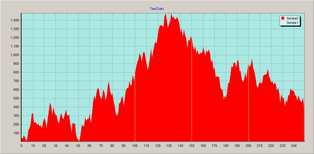

Re: TChart Legend
Post by Yeray » Thu Mar 25, 2010 10:46 am
Hi Brian,
The following code tries to do a chart as similar as possible to yours:
Private Sub Form_Load()
  TeeCommander1.Chart = TChart1
  TChart1.Aspect.View3D = False
  TChart1.AddSeries scArea
  TChart1.Series(0).FillSampleValues 250
  TChart1.Series(0).asArea.AreaPen.Visible = False
  TChart1.Series(0).Pen.Visible = False
  TChart1.AddSeries scVolume
  TChart1.Series(1).Color = vbYellow
  With TChart1.Series(0)
    TChart1.Series(1).AddXY .XValues.Value(50), .YValues.Value(50), "", clTeeColor
    TChart1.Series(1).AddXY .XValues.Value(100), .YValues.Value(100), "", clTeeColor
    TChart1.Series(1).AddXY .XValues.Value(150), .YValues.Value(150), "", clTeeColor
    TChart1.Series(1).AddXY .XValues.Value(200), .YValues.Value(200), "", clTeeColor
  End With
  With TChart1.Legend
    .CustomPosition = True
    .Left = 900
    .Top = 50
    .Transparency = 50
  End With
  With TChart1.Walls.Back
    .Color = RGB(128, 255, 255)
    .Transparent = False
    .Transparency = 50
  End With
  TChart1.Environment.InternalRepaint
  TChart1.Export.asJPEG.SaveToFile "C:\tmp\test.jpg"
End Sub
Both the generated test.jpg and saving it through the commander gives the same result for me here:
Could you please modify the code above or send us a simple example project we can run as-is to reproduce the problem here?

Re: TChart Legend
Post by XRS » Thu Mar 25, 2010 7:42 pm
Yeray,
I was not able to duplicate the problem with your project. In the end I was able to fix it on my side by using the custom positioning setup for the Legend, programmatically similar to what you had done, rather than using the Designer to set it up with Percent Margins. The strange thing is that it worked with v.6 and 7 of TChart, but not v.8. It was only a problem with saving to JPEG, not with BMP.
Anyway, thanks for your help,
Brian
