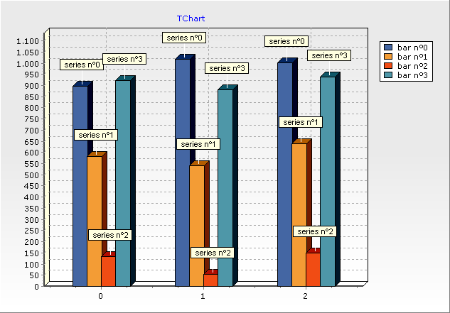

We've just added a LegendTitle property to the Series. We've added it in the actual VCL sources but it should be available in the next ActiveX build.
Right now, I can show you the code in VCL that works for me here:
var i: Integer;
  for i:=0 to 3 do
    with Chart1.AddSeries(TBarSeries) do
      FillSampleValues(3);
      LegendTitle:='bar nº' + IntToStr(i);
      Title:='series nº' + IntToStr(i);
      Marks.Style:=smsSeriesTitle;
