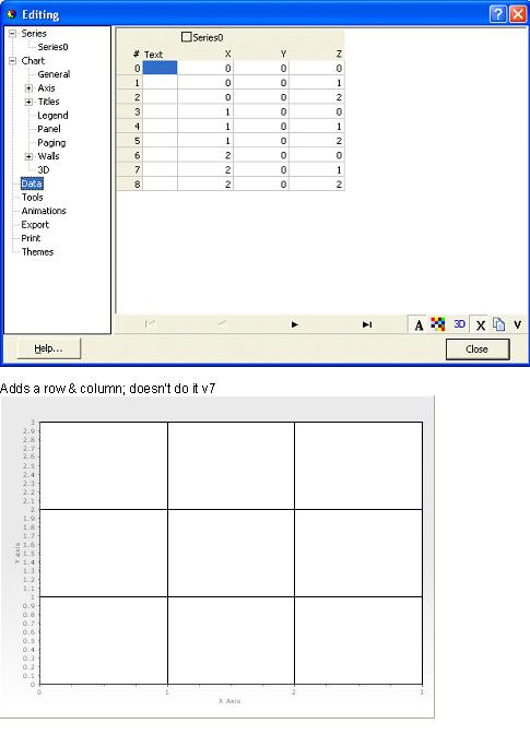

Here are some screenshots of the problems in my first post. The data goes to 2 in x and y but the grid adds a row and column so that it goes to 3 in both directions. Colorgrid didn't do this in v7.
colorgrid problems.JPG (33.74 KiB) Viewed 8706 times

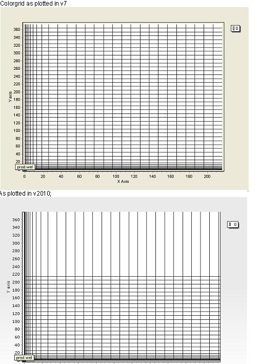

This demonstrates the missing gridlines issue by comparing two plots of identical data and identical code (except one is using AXv7 and the other AXv2010)
Missing gridlines
colorgrid problems 2.JPG (82.04 KiB) Viewed 8714 times

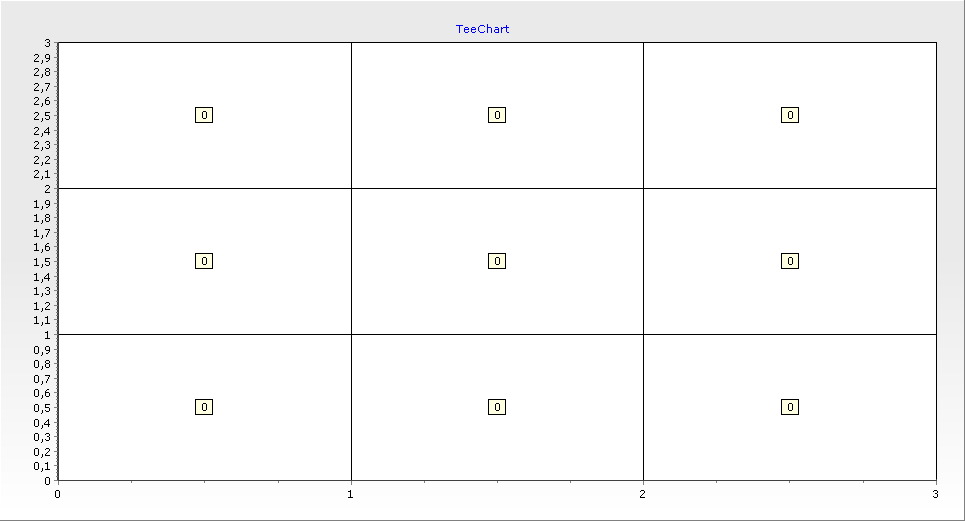

I'm running this code in TeeChart v7.0.1.4 and v2010.0.0.2 and I got the same result that I think is the expected:
Private Sub Form_Load()
  TeeCommander1.ChartLink = TChart1.ChartLink
  TChart1.Aspect.View3D = False
  TChart1.AddSeries scColorGrid
  Dim nCols, nRows, x, z As Integer
  nCols = 3
  nRows = 3
  For x = 0 To nCols - 1
    For z = 0 To nRows - 1
      TChart1.Series(0).asColorGrid.AddXYZ x, 0, z, "", clTeeColor
    Next z
  Next x
  TChart1.Series(0).Marks.Visible = True
End Sub
Private Sub TChart1_OnGetSeriesMark(ByVal SeriesIndex As Long, ByVal ValueIndex As Long, MarkText As String)
  If SeriesIndex <> -1 And ValueIndex <> -1 Then
    With TChart1.Series(SeriesIndex)
      MarkText = "(" + Str$(.XValues.Value(ValueIndex)) + ", " + Str$(.YValues.Value(ValueIndex)) + ", " + Str$(.asColorGrid.ZValues.Value(ValueIndex)) + ")"
    End With
  End If
End Sub
You may be interested in reading the explanation here about how to populate this type of series.

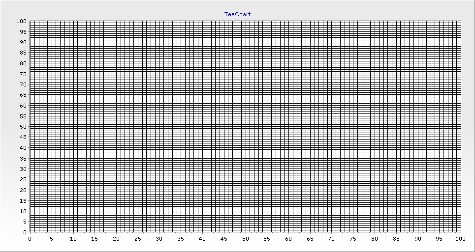

I'm incrementing the nCols and nRows values to 100 (and hiding the marks) and everything looks fine to me:
Could you please modify the example above so we can reproduce the problem here? Or could you please send us a simple example project we can run as-is to reproduce the problem here?
