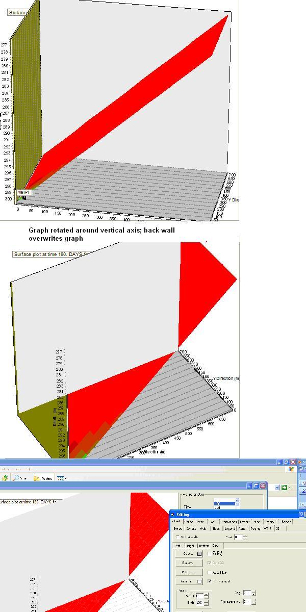

I'm having a problem with the back wall overwriting the graph when it is rotated in 3D graphs. Even though I set walls not to be visible in the editor the back wall is still visible and won't go away. Am I doing something wrong here; is this something you've come across before?

Hi Luke,
I can't see this effect in the following example:

Hi Yervay, Thanks for your reply. I eventually discovered the cause was the Grid Band Tool; making this inactive stopped the problem. Regards Luke

Hi Luke,
Thanks for the information. I've reproduced it so I've added it to the defect list to be fixed in future releases (TV52015304)
