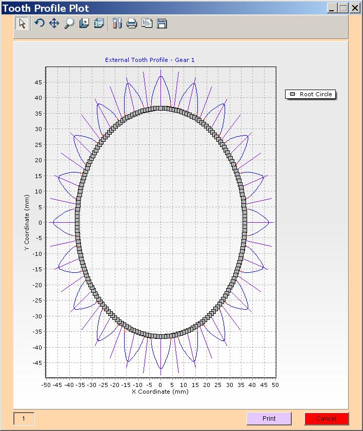

I'd like to plot a gear with teeth and some circle, as show in the Figure 1 below. I am using TChart ActiveX control in MFD dialog. What I got does not have the right aspect ratio, i.e. the circle looks like an ellipse.
1. I tried making the chart width and height the same, but still the scales of x axis and y axis are not exactly the same. How can I make the scale of x and y the same?

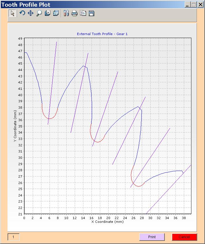

3.In the case that the X range (Xmin~Xmax) and Y range (Ymin~Ymax) are not the same, for example only plot several teeth, the tooth shape will be distorted as shown in Figure 2. So how to fix it?
I think that a good option for your is use Anti-Alaising tool. You can find an example in TeeChartActiveX Demo Project concretely All Features\Tools\Antialias Filter
