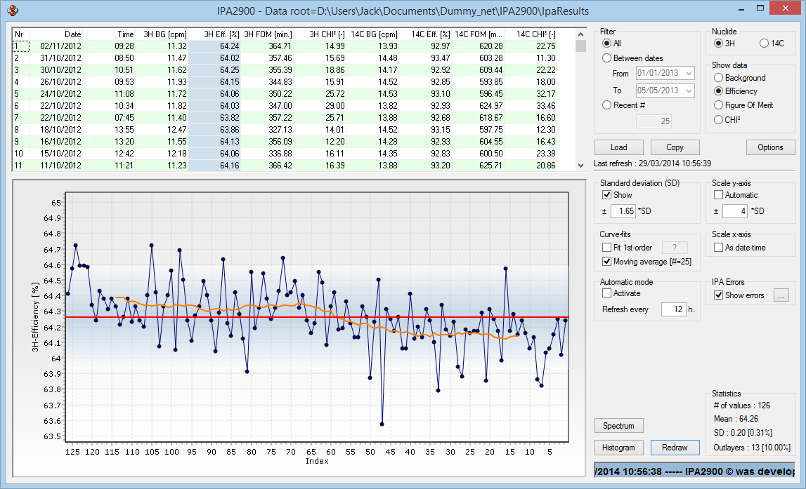

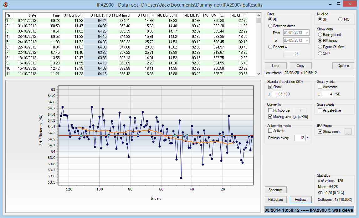

Tried the 2014beta. The first thing I noticed was that a chart defined in TC2013 doesn't look the same in 2014beta. They don't have the same position. I tried to correct this with the internal margins but no luck.
TC2013
TC2014
Am I doing something wrong or can I correct this?
Also I noticed that the dots intersecting the horizontal red line are displayed differently. The red line turns cyan.

Hello Jack,
Jack@007 wrote:The first thing I noticed was that a chart defined in TC2013 doesn't look the same in 2014beta. They don't have the same position. I tried to correct this with the internal margins but no luck.
Can you please arrange a simple example project we can run as-is to reproduce the problem here?
Jack@007 wrote:Also I noticed that the dots intersecting the horizontal red line are displayed differently. The red line turns cyan.
Not only the dots. Every line crossed with the TColorLineTool seems to be drawn in a blend color.
I've added it to the public tracker.
http://bugs.teechart.net/show_bug.cgi?id=687
Feel free to add your mail account to the CC list to be automatically notified when an update arrives.
