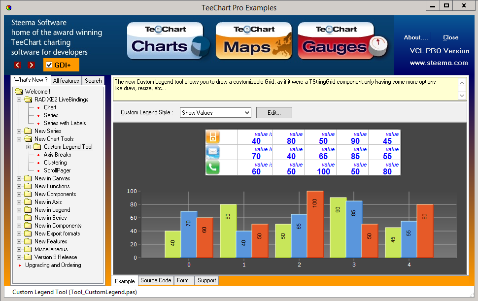

In this direction, you may be interested in the Custom Legend Tool, available for TeeChart VCL: Here it is how it looks:
However, I'm afraid some features are still missing in this tool for TeeChart ActiveX as you can read here.
