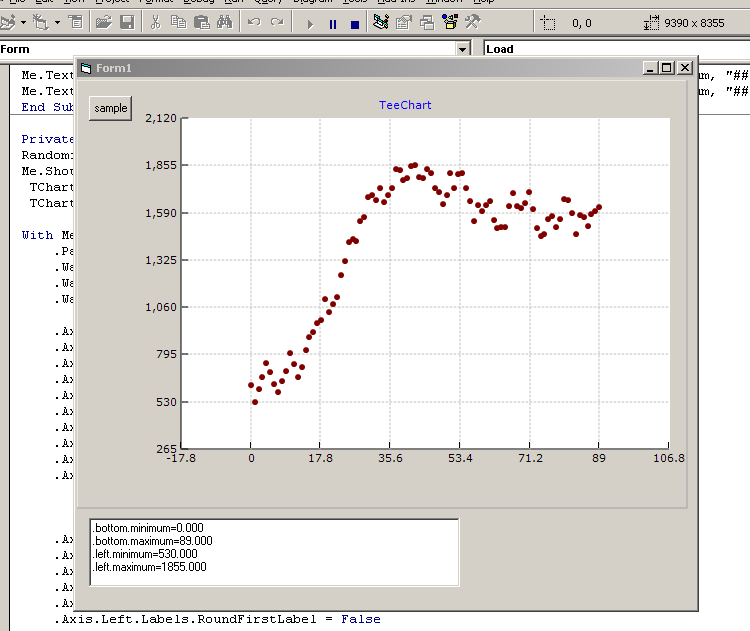

Guys let me ask you about this behavior:
when I set the axis offset property and after this if I read the maximum/minimum property I got the maximum and minimum values of the axis before the offset, so the values are not the ones displayed at the chart
The question: is it normal ? Seems that I have to calculate by myself the real values of the maximum and minimum of the chart to calculate correctly the increments
It seems that MaximumRound/MinimumRound also does not take in account the offsets or I did not understand how the round works in teechart (see the pic)
Here is the code to show all above.

Strange... if I comment the lines with MinimumOffset and MaximumOffset it seems to not change anything, i.e., the offsets still are applied....
Re: axis Maximum, Minimum and the Offset and related
Post by Yeray » Thu Nov 20, 2014 9:40 am
The Offsets set are applied internally without modifying the Minimum&Maximum properties.
If you want to calculate the resultant Minimum&Maximum, you could do this:
    With .Axis
      Text1.Text = ""
      Text1.Text = ".bottom.minimum=" + Format(.Bottom.CalcPosPoint(.Bottom.IStartPos), "#####0.000") + vbCrLf
      Text1.Text = Text1.Text + ".bottom.maximum=" + Format(.Bottom.CalcPosPoint(.Bottom.IEndPos), "#####0.000") + vbCrLf
      Text1.Text = Text1.Text + ".left.minimum=" + Format(.Left.CalcPosPoint(.Left.IEndPos), "#####0.000") + vbCrLf
      Text1.Text = Text1.Text + ".left.maximum=" + Format(.Left.CalcPosPoint(.Left.IStartPos), "#####0.000") + vbCrLf
    End With
