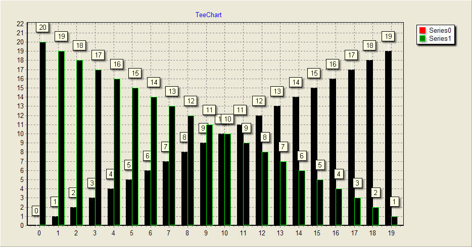

I am trying to plot a barchart in color, but I can't get main part of the bar-chart to plot in color. I can get the border to change colors, but not the main box of color.

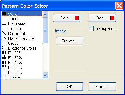

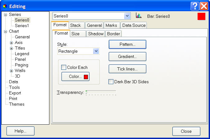

I've tried every combination in the TeeChart editing dialog box Series->Series0->Format tab->Format tab to try to get any other color than black on the bar graph but no luck.
I also tried setting the color parameters during runtime but that didn't work either.
I use a very simple code on this test
void CTeeChartTestDlg::OnBnClickedOk()
	// TODO: Add your control notification handler code here
	unsigned int i, I = 20;
	for(i=0; i<I; i++) {
		m_Chart1.Series(0).AddXY(i,i, L"", 0);
		m_Chart1.Series(1).AddXY(i, I-i, L"", 0);
I'm using a simple non-3D graph but what I don't know what I'm missing. I've attached screenshots of the settings in the settings editor and a screenshot of what I get.
The border on series0 is not set (i.e. no boarder on series0) but you can see that the border comes out correctly on series1.
btw: For line-graphs I can get the colors to come out fine, just not bar charts.

The problem is that you are a assigning a color to each point when adding data to the series. Therefore you can not change series color if each point has been assigned a color individually.
So that it works as you request you should use clTeeColor constant as the color in the AddXY method when populating your series. Then you could set series color both at runtime or in the editor.

Thanks, that was it.

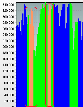

I have 3 bar series on my chart, the one is Color.Lime the other Color.Blue, but the one I marked with a Red circle is actually Color.Red. Why is this not 255 type Red...?
Color.Red not 255 type Red
MyChart.Series(0).Color =System.Convert.ToUInt32(System.Drawing.ColorTranslator.ToOle(Color.Red));
Re: Bar chart isn't in color (mostly)
Post by Narcís » Thu Sep 03, 2009 8:47 am
Hi Otokon,
I'm not able to reproduce the problem here using code snippet below. Can you please modify it or attach a simple example project we can run "as-is" to reproduce the problem here?
