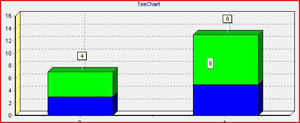

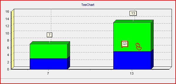

There are some screenshot.
Before to call RecalcTotals.
After to call RecalcTotals.
The values display with the tcMarksTip change for the total. I try to display each values ( Value of serie(0), Value of serie(1), total of two series).
