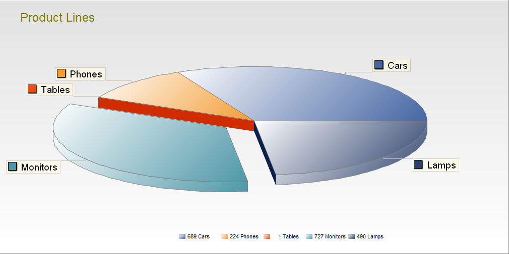

I was looking at http://www.steema.com/uploads/gallery/PieExploded.png. The pie chart there looks a lot nicer and smoother than that I can draw. Is there a way to produce that kind of look?

Hi raymond,
First of all notice that TeeChart ActiveX is a wrapper from the TeeChart VCL version. The charts in the pictures you refer were plotted using TeeChart for .NET and some of Microsoft .NET Framework drawing techniques are not available in the VCL framework.
On the other hand, find the code below written in VB6 that tries to obtain a pie chart with the ActiveX version as similar as possible to the .NET charts seen in the gallery.
Private Sub Form_Load()
 With TChart1
   .ApplyPalette cpOpera
       With .Panel.Gradient
     .Visible = True
     .EndColor = RGB(225, 225, 225)
   End With
   With .Header
     .Text.Text = "Product Lines"
     .Font.Color = RGB(128, 128, 0)
     .Font.Size = 18
     .Alignment = taLeftJustify
   End With
   With .Legend
     .Alignment = laBottom
     .Transparent = True
     .Symbol.Shadow.Visible = False
   End With
   .AddSeries scPie
   With .Series(0)
     .FillSampleValues 5
     With .asPie
       .PiePen.Visible = False
       With .Gradient
         .Visible = True
         .Direction = gdDiagonalDown
         .Balance = 30
       End With
       .PieMarks.LegSize = 50
       .ExplodeBiggest = 20
     End With
     With .Marks
       .Symbol.Visible = True
       .Symbol.Shadow.Color = clGrayText
       .Font.Size = 14
       .Frame.Color = RGB(202, 164, 136)
       .Arrow.Color = RGB(216, 189, 169)
       .Transparency = 50
     End With
   End With
   .Tools.Add tcAntiAlias
 End With
End Sub
Here is how it looks:
