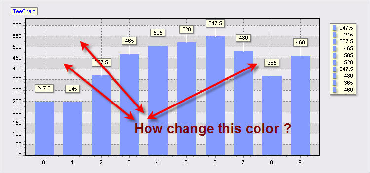

hi,
I'd like to set/change color band in Fast Line Serie. How can i do that ? Where is this property in the Teechart editor ?
In my sample it is not a Fast Line serie but I would like do the same in a Fast Line serie
Thanks a lot for your help

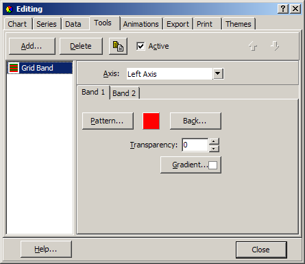

Through the editor, you should find it in "Tools\Grid Band\Band 1" there is a color shape, clicking on it, it shows the color picker.
