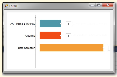

I have a bar graph and the last entry is not showing if the value is zero.
Example code
axTChart1.Series(0).Add(1, "AC - Milling & Overlay", 536870912);
axTChart1.Series(0).Add(1, "Cleaning", 536870912);
axTChart1.Series(0).Add(3, "Data Collection", 536870912);
axTChart1.Series(0).Add(0, "Inspect", 536870912);
axTChart1.Axis.Left.Ticks.Visible = false;
axTChart1.Series(0).Marks.Style = TeeChart.EMarkStyle.smsValue;
axTChart1.Series(0).Marks.Font.Color = 1776411;
axTChart1.Series(0).Marks.Clip = false;
axTChart1.Series(0).SortByLabels(TeeChart.EValueListOrder.loDescending);
Inspect is the value that does not show up is it is zero. If I make it any other value is does show up. The other entries always show up even is they are zero. Attached is a visual studio 2010 project showing the problem.

Post by Yeray » Mon Nov 22, 2010 2:23 pm
Hi Cartegraph,
I've seen that in your chart you've set Left Axis MinimumOffset to 32 and Left Axis MaximumOffset to 37. I've seen that setting the same Minimum and Maximum Offsets, the problem disappears:
axTChart1.Axis.Left.MaximumOffset = axTChart1.Axis.Left.MinimumOffset;
Could you please confirm it?

Post by Cartegraph » Mon Nov 22, 2010 2:32 pm
That worked! Thanks for the quick reply!
