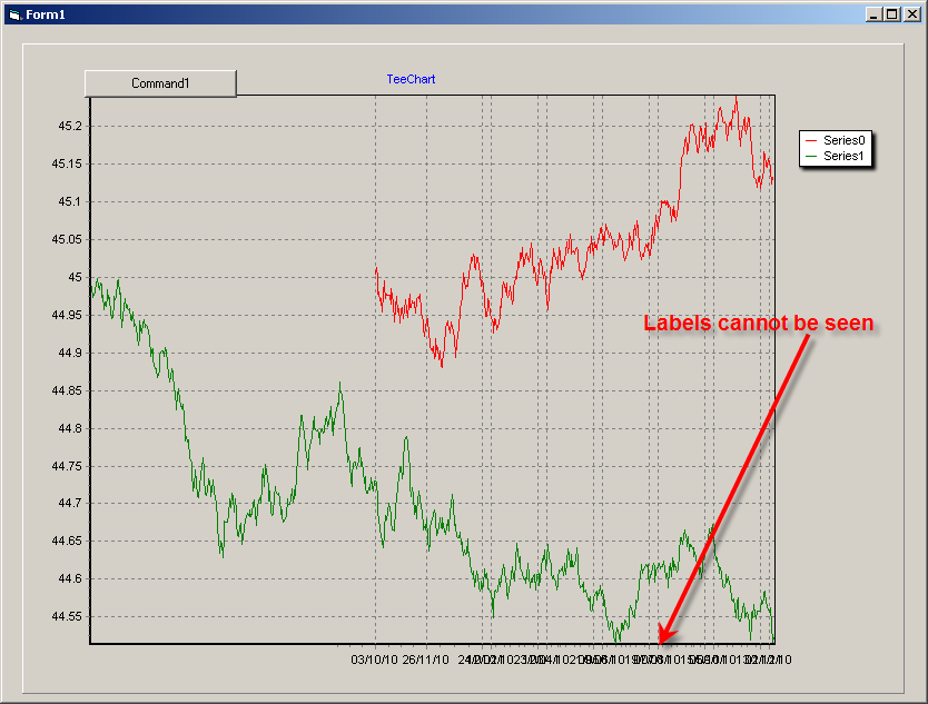

I would like to chart 2 series with .XValues.DateTime = False . 1st one charted on form load and 2nd one on button click.
2nd serie is larger then 1st serie. In this case I have the issue listed below.
Example code
Option Explicit
Private Sub Command1_Click()
        TChart1.AddSeries (scFastLine)
        TChart1.Series(1).asFastLine.TreatNulls = tnSkip
        TChart1.Series(1).XValues.DateTime = False
        Dim i As Integer
        Dim value As Double
        value = 45
        For i = 1 To 720
            value = value + 0.03 * (Math.Rnd() - Math.Rnd())
            TChart1.Series(1).AddXY i, value, Format(Now - 720 + i, "dd/mm/yy"), clTeeColor
        Next i
End Sub
    Private Sub Form_Load()
        TChart1.Aspect.View3D = False
        TChart1.Axis.Bottom.Labels.DateTimeFormat = "dd/mm/yy"
        TChart1.Series(0).asFastLine.TreatNulls = tnSkip
        TChart1.Series(0).XValues.DateTime = False
        Dim i As Integer
        Dim value As Double
        value = 45
        For i = 300 To 720
            TChart1.Series(0).AddXY i, value, Format(Now - 365 + i, "dd/mm/yy"), clTeeColor
        Next i
    End Sub
Have you any idea how can I correct this.
Re: Labels issue with 2 series
Post by Yeray » Thu Dec 09, 2010 3:48 pm
Hi Petar,
I think this is the same problem that was identified here.
So when TV52015179 will be fixed in VCL, it should become fixed in ActiveX too because TeeChart AX is a wrapper from TeeChart VCL.

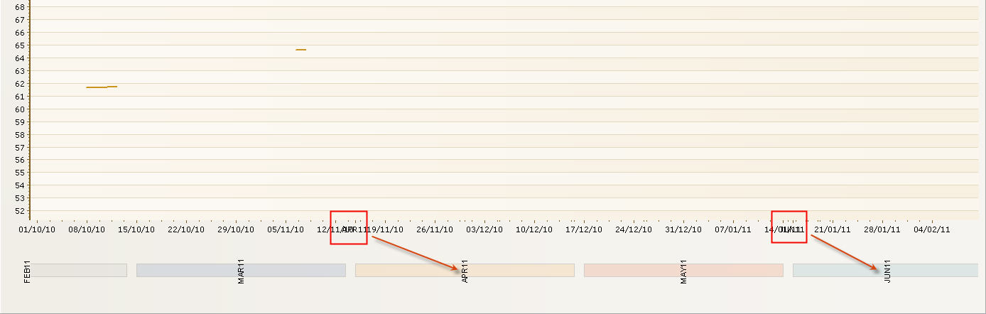

Post by guilz2010 » Mon Nov 07, 2011 12:54 pm
with Teechart v2011 we still have this bug
As you can see, we have 2 series (1 as fast line - Serie1, 1 as Gantt - Serie 2) the issue is that Gantt label are displayed on the bottom axis and we can't see the date labels of serie 1
We do not want to view Gantt labels on bottom axis but we want view them on Gantt chart (Months FEB11, MAR11, APR11, MAY11, JUN11 must be displayed on gantt chart but not on bottom axis where there is already date labels of serie 1
Thank you for your help
Guilz
Post by Yeray » Tue Nov 08, 2011 12:14 pm
I've verified with v2010.0.0.1 this reproduced the problem but not now with v2011.0.0.4:
  Dim i, j As Integer
  Dim cxdate As Date
  For i = 0 To 1
    TChart1.AddSeries scFastLine
    cxdate = Date
    For j = 0 To 49
      TChart1.Series(i).Add Rnd(100), FormatDateTime(cxdate), clTeeColor
      cxdate = cxdate + 31
    Next j
  Next i
End Sub
However, the code from Petar, in the beginning of this thread still reproduces the overlapping problem:
  Dim i As Integer
  Dim value As Double
  value = 45
  For i = 300 To 720
  Next i
  value = 45
  For i = 1 To 720
  Next i
End Sub
So this could be an slightly different problem than TV52015179.
I've opened a new VCL bug ticket with the code above translated to Delphi, that reproduces the problem for me here with the actual sources (TV52015820).
Excuse us for the confusion generated.
