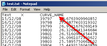

When exporting chart in XLS format, Series Names does not appear, it just indicates "Y".
Export in XLS format:
As you can see, Export in TXT format include Series Names. But this export doeas not work for me , because it exports all Null values( xls exports empty cells).
How can I get Series Names in XLS export?

Hi Petar,
You have to set the Name property of the lists exported:
    TChart1.Series(0).XValues.Name = "AA"
    TChart1.Series(0).YValues.Name = "BB"
