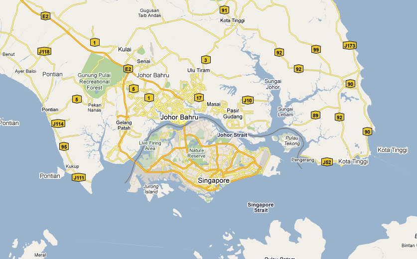

Well, it's not an island but in TeeChart it looks like one... :oops:
Here it is in Google Maps:

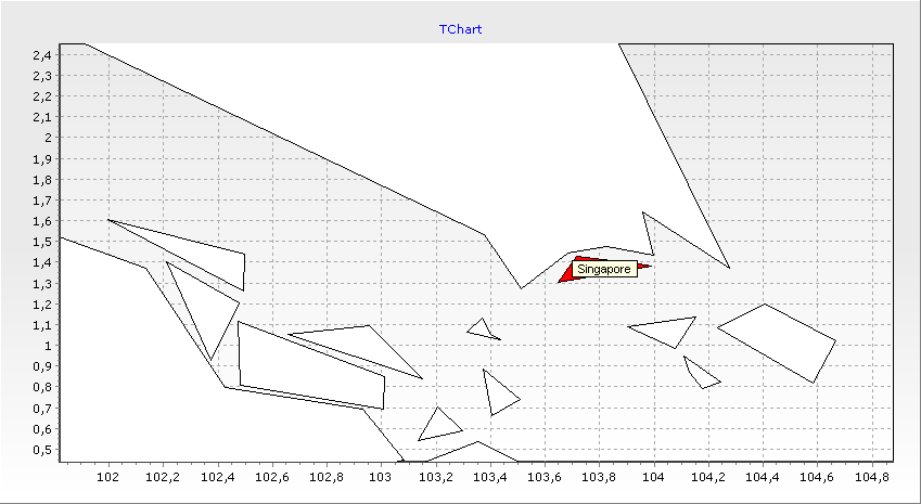

And here it is with the following code in TeeChart:
uses TeeWorldSeries;
var Series1: TWorldSeries;
var i: Integer;
  Chart1.View3D:=false;
  Chart1.Legend.Visible:=false;
  Series1:=Chart1.AddSeries(TWorldSeries) as TWorldSeries;
  Series1.Map := wmWorld;
  Series1[1839].Text:='Singapore';
  Series1[1839].Color:=clRed;
  Series1.Marks.Visible:=true;
  Series1.OnGetMarkText:=Series1GetMarkText;
procedure TForm1.Series1GetMarkText(Sender: TChartSeries; ValueIndex: Integer; var MarkText: String);
  if Series1[ValueIndex].Text <> 'Singapore' then
    MarkText:='';

My may doesn't look nearly as nice as yours when I use TCommander to zoom in:
What am I doing wrong? Also I still can't identify Singapore on my map. Here is the code I am using to turn on some colors. Malaysia and Indonesia show up but Singapore doesn't:
