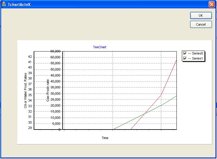

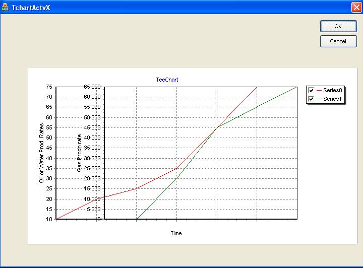

I am using TeeChart ActiveX v7. I have added a vertical custom axes in a MFC dialog application. I am noticing that on zooming, the custom Axis( labels) does not change. The attachments show the "Gas Prod rate" custom vertical axes and its behavior before and after zoom.
Girish
Snapshot showing custom axe after zoom
Snapshot showing custom axe before zoom

Zooming is not supported on custom axes. Please read this link on how to zoom custom axes. It's a Delphi item but sames applies to other TeeChart versions.
