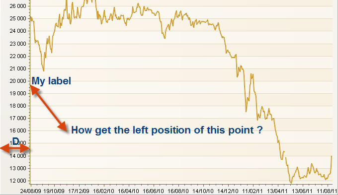

I would like to get the distance D (see my example) on a chart ?- How can I retrieve it ? D distance can change if numbers on left axis have more numbers !
Thanks for your help :wink:
Guilz

D is the Left Axis Position property. You could, for example:
  TChart1.Canvas.Font.Size = 10
  TChart1.Canvas.Font.Bold = True
  TChart1.Canvas.Font.Color = vbBlue
  TChart1.Canvas.TextOut TChart1.Axis.Left.Position, 100, "My label"
End Sub
Note that this property needs the chart to be drawn to have a valid value.

Thank you Yeray - I was not aware that property TChart1.Axis.Left.Position could be read only after AxTChart_OnAfterDraw event
