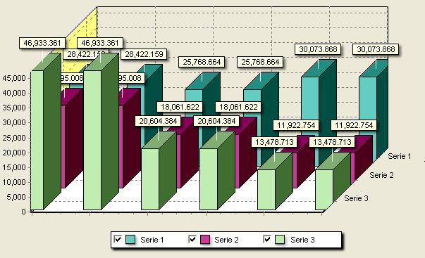

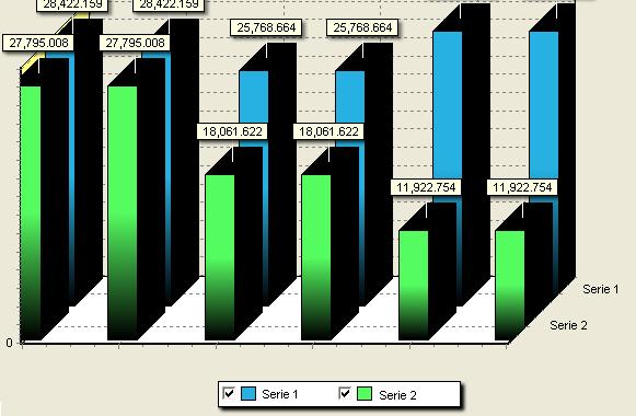

We are exploring plots with bar series type. In the attachment you can see how the color of each serie goes to black with the gradient property. Using the following code:
TCrart1:Series(p-SeriesIndex):asBar:Gradient:StartColor = RGB-VALUE(RANDOM(0,255),RANDOM(0,255),RANDOM(0,255))
TCrart1:Series(p-SeriesIndex):asBar:Gradient:MidColor   = TCrart1:Series(p-SeriesIndex):asBar:Gradient:StartColor
TCrart1:Series(p-SeriesIndex):asBar:Gradient:EndColor   = TCrart1:Series(p-SeriesIndex):asBar:Gradient:StartColor
TCrart1:Series(p-SeriesIndex):COLOR = TCrart1:Series(p-SeriesIndex):asBar:Gradient:StartColor
Is it black the default color that appears on the depth and top of each bar? How can I change it?
Besides, the first bar at the left appears truncated, it does not have the same width as the others. The same comment is valid for the extreme right serie but with the depth side of the bar, as is clearly seen in the image. Is there a command that we are missing?

We almost forgot that any time that the plot is exported to PDF format, the bars appear completely black.

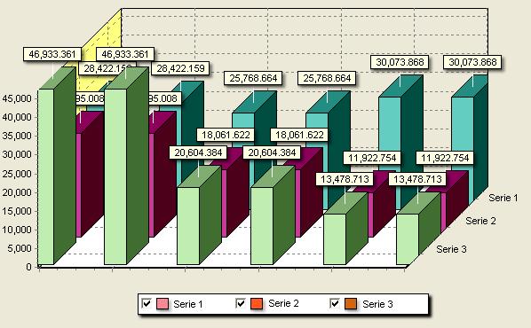

We realized that the problem was not with the bars color settings but the command used to create the series (ADD). The third parameter in this instruction was setting as zero, and this parameter is the default color, in this case, black.
Now this is working correctly (we changed to rectangle type instead of gradient bars as you suggested), but we have to reconfigurate the OnClickSeries event: this is used to change the color just in case the user want to:
TChart1.Series(p-SeriesIndex).COLOR = RGB-VALUE(RANDOM(0,255),RANDOM(0,255),RANDOM(0,255))
What extra code we need for change no just the legend color but also the bars color? (attachments)
Please, we still have the truncating issue with edge bars. We are not setting axis manually. We're using the following code:

After OnClickSeries event
Before OnClickSeries event

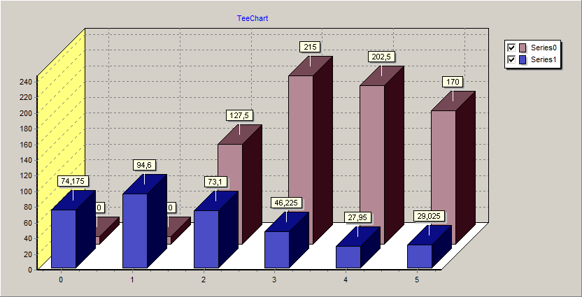

The graphic is wonderful, but we have two issues:
1. Still have problems with the truncation of the series at the edge.
2. We add the rotation of the graph as a new function, but the ClickOnSeries event is not working properly, it seems like the program misses the original position of the series. We are not sure how come it back to the original position so we could change the color or how we could change de color in the new position of the graphic.
