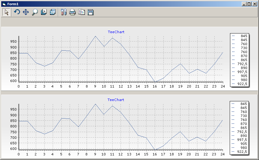

Re: Some settings not saved in TChart 2011.
Post by Yeray » Tue Feb 28, 2012 3:38 pm
With that code I get two charts looking the same (with TeeChart v2011.0.0.5):
