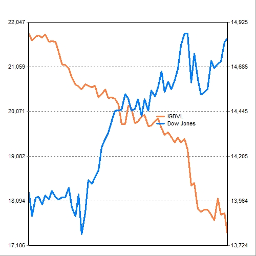

I wanna create a graph with the left axis in Orange color, but the graph is generated with the left axis in black color.
This is part of my code
w_AxeYvalue = wMinimunY1
With Grafico.TChart1.Axis.Left.Labels
.Clear
.Font.Color = RGB(255, 128, 64)
For i = 1 To 6
.Add w_AxeYvalue, Format$(w_AxeYvalue, "###,##0")
w_AxeYvalue = w_AxeYvalue + wStepY1
Next i
End With
What is missing?

Grafico.TChart1.Axis.Left.Labels.Font.Color = RGB(255, 128, 64)
But the axis label is print in black Color (like the attach image)
What is missing?

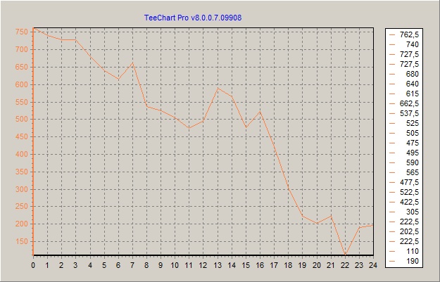

Hi Yeray
With the Narcís's suggest
TChart1.Axis.Left.AxisPen.Color = RGB(255, 128, 64)
Only the Axis lines is changed, but not the text label
I'm ussing VB6, and Windows 7

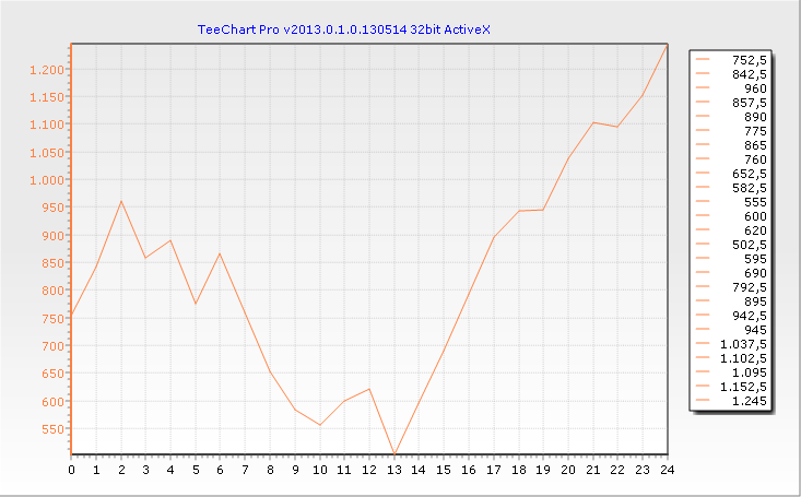

What exact TeeChart version are you using?
It works fine for me here with v2013.0.1.0 and also with v2012.0.0.9:

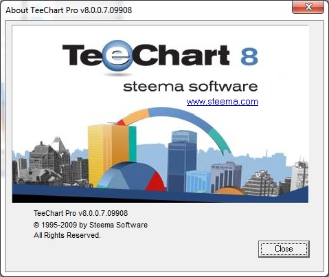

Hi Yeray
This is my version
TeeChart Pro v8.0.0.7.09908
Best regards
This is my version
Best regards

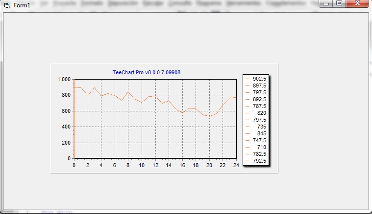

Hi Yeray
Please try this
The left labels titles are in black color, only the left's axis line is orange, and I need the titles in orange
Thanks a lot
Please try this
Thanks a lot

Hi Daniel,
Ah, I see the font formatting didn't work fine when using custom labels in TeeChart ActiveX v8. It works fine from TeeChart ActiveX v2010.0.0.1.
