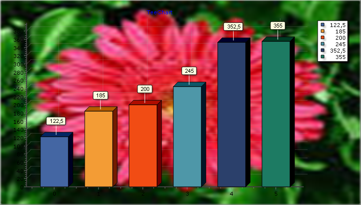

If you want to show the image in the background, you could load it in the panel or in the back wall. Something like this:

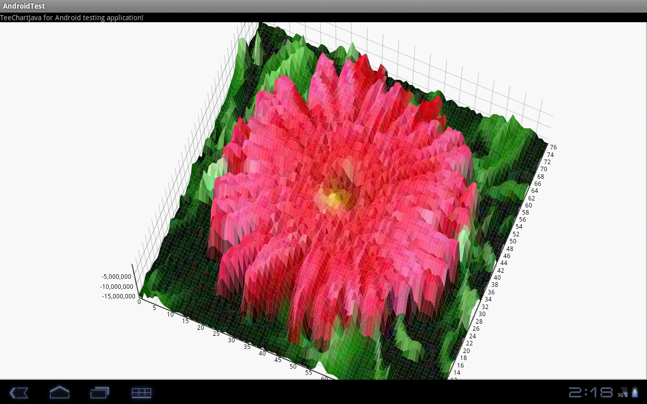

If you want to load the image in a series, you may want to do something like in the image below. We did this example with TeeChart Java for Android:
