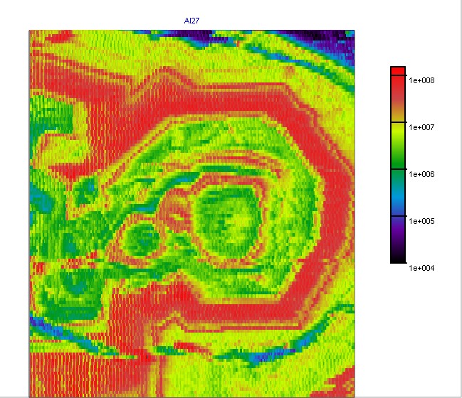

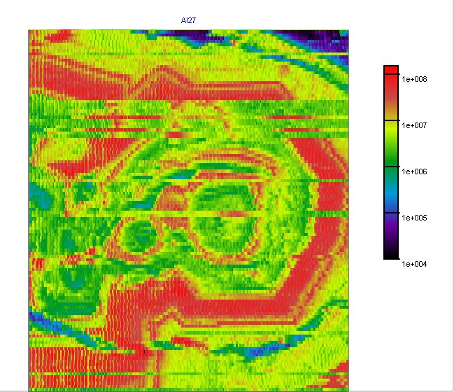

Thank for your quick reply.you solved my problem,but there occurs another problem:I cannot save images entirely. Teechart' painting is not finished,but images have been saved.If I save image when program finished,I can save entire image.In my program, If I select auto save checkbox and the mapping element, I can map all of them. Parts of codes are:

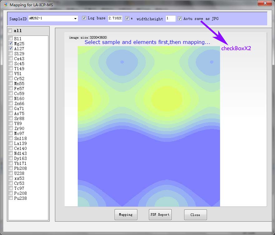

I attached my interface image, images saved automatically and manually.

image saved manually,It was the last right result shown on my screen.
not finished image,but it was saved by program
interface
