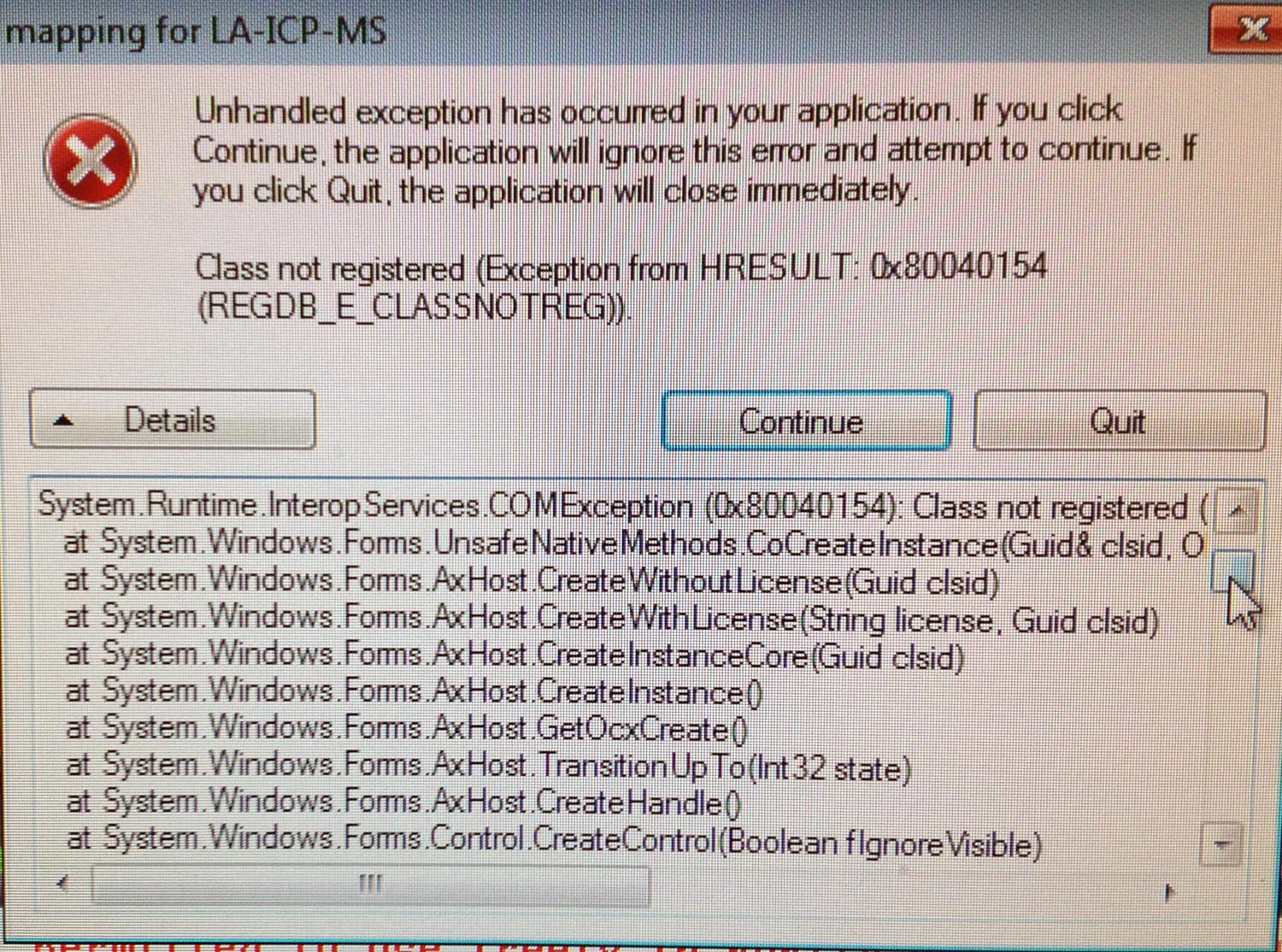

Hi,Yeray,

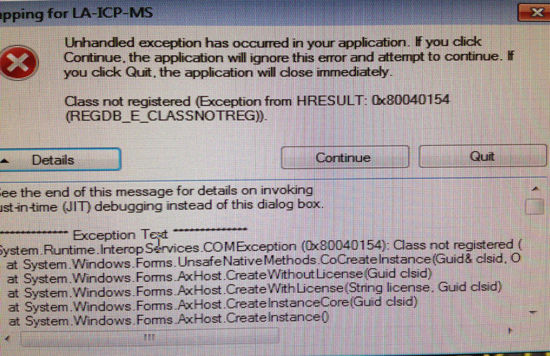

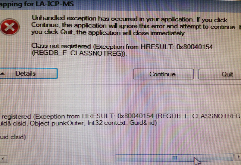

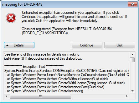

I have finished my program with Vs2008 c#, OS is window7(32bit)and want to install it to windows7 (64bit). After I finish my setup,if I run the winform with TeeChart,program lists many errors(see attached).How to solve it?

Re: How to publish my program?
Please, take a look at the "Tutorial 18 - TeeChart runtime installation requirements" shipped with the installation.

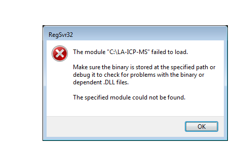

I tried to register teechart on the target computer ,but I failed. I installed my software to c:\la-icp-ms mapping,and run regsvr32 c:\la-icp-ms mapping\TeeChart2013.ocx,error occurs,see my attached file. The target computer is win7(64bit).I checked the folder of " la-icp-ms mapping" and I have found TeeChart2013.ocx in it.

Since the path has spaces, try using "":
regsvr32 "c:\la-icp-ms mapping\TeeChart2013.ocx"

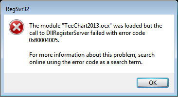

Hi,Yeray,
I registered Teechart2013 on a computer with window 64 bit successfully,but when I tried to register it on another computer with window 7 64bit,error happened.See my image.
Robinson
Hi,Yeray Alonso,
I searched the error number, do I run regsvr32 as an administrator?
Robinson

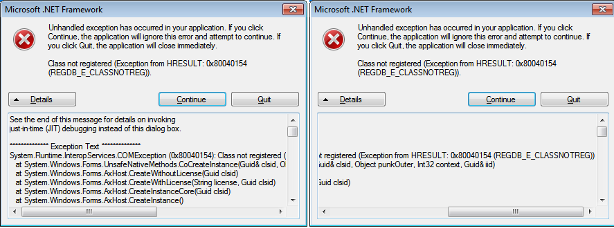

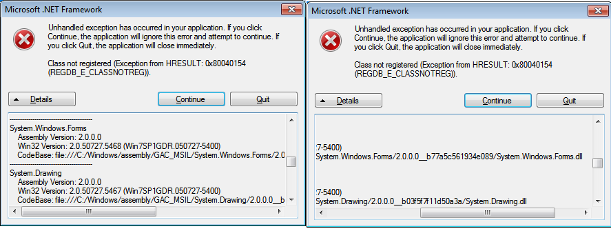

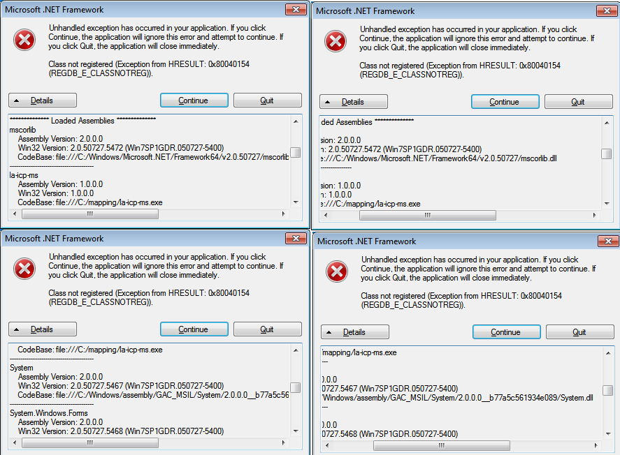

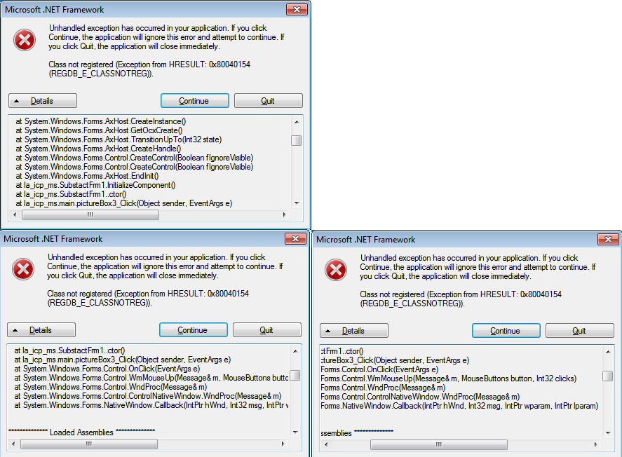

Thanks for your quick reply.I registered your teechart2013 on computer window7 64bit,and computer told me my register is successful,but when I run winform with your teechart,errors appeared.I installed my program in folder of c:\mapping,and I registered Teechart2013:
1. Click on Start button > type Command Prompt > (right click command prompt and click run as Administrator)
2. Reregister Teechart2013.ocx using command:
cmd > regsvr32 c:\mapping\teechart2013.ocx
Computer told me register is successful. I caught errors on screen to you,please help me to sovle it.

- error1
- error1.png (31.11 KiB) Viewed 32153 times
- error2
- error2.png (65.27 KiB) Viewed 32128 times
- error3
- error3.png (58.11 KiB) Viewed 32135 times

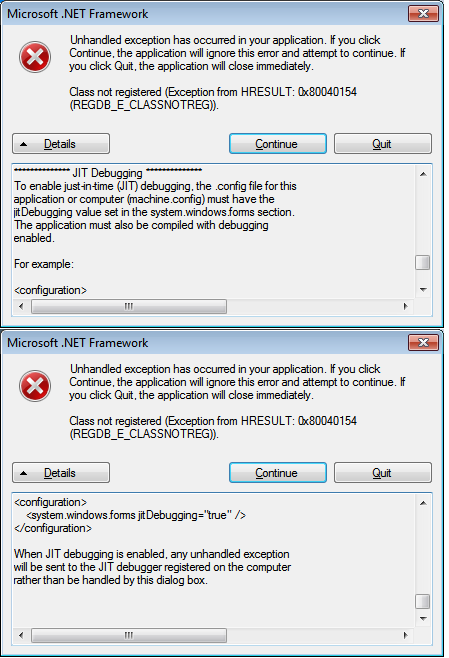

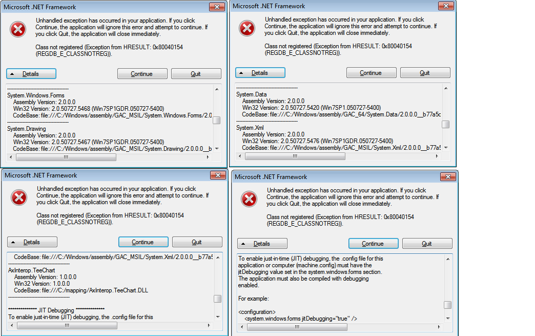

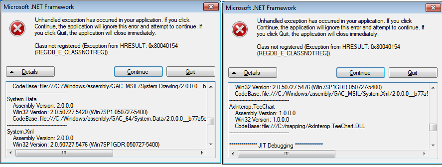

next errors
- error6
- error6.png (32.42 KiB) Viewed 32151 times
- error5
- error5.png (29.93 KiB) Viewed 32143 times
- error4
- error4.png (57.66 KiB) Viewed 32146 times
the last error interface
- error7
- error7.png (35.11 KiB) Viewed 32133 times

Hi,Yeray,
I see:http://www.teechart.net/support/viewtop ... t=14454,It told me compiling the application at 32 bit instead of 64.I just complied the application at 32bit,but errors happens on target window7 64bit.
Do I either compile my program at 32bit, copy it directly to my disk and regsvr32 it?or just compile my program at 64bit?
