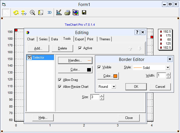

1) When I add the Selector Tool via the Editor, I can only resize the chart by dragging the bottom right corner. Is there a way to resize it by saying dragging the right edge out or bottom edge down?
2) What is the function of the the handles that appear on the chart when selected via Editor -> Tools -> Add Selector?
3) How can I add the ability to drag (ie turn drag on) via my C+= code? I'm using TeeChart Pro ActiveX version 7.

nbp wrote:2) What is the function of the the handles that appear on the chart when selected via Editor -> Tools -> Add Selector?
Do you mean the Handle button in the Selector editor?
You can change the pen used to draw the selection squares highlighting the selected element.
nbp wrote:3) How can I add the ability to drag (ie turn drag on) via my C+= code? I'm using TeeChart Pro ActiveX version 7.
In VB6 it's:
  TChart1.Tools.Add tcSelector
  TChart1.Tools.Items(0).asSelector.AllowResizeChart = True
If you still find problems doing the same in VC++, don't hesitate to let us know.
