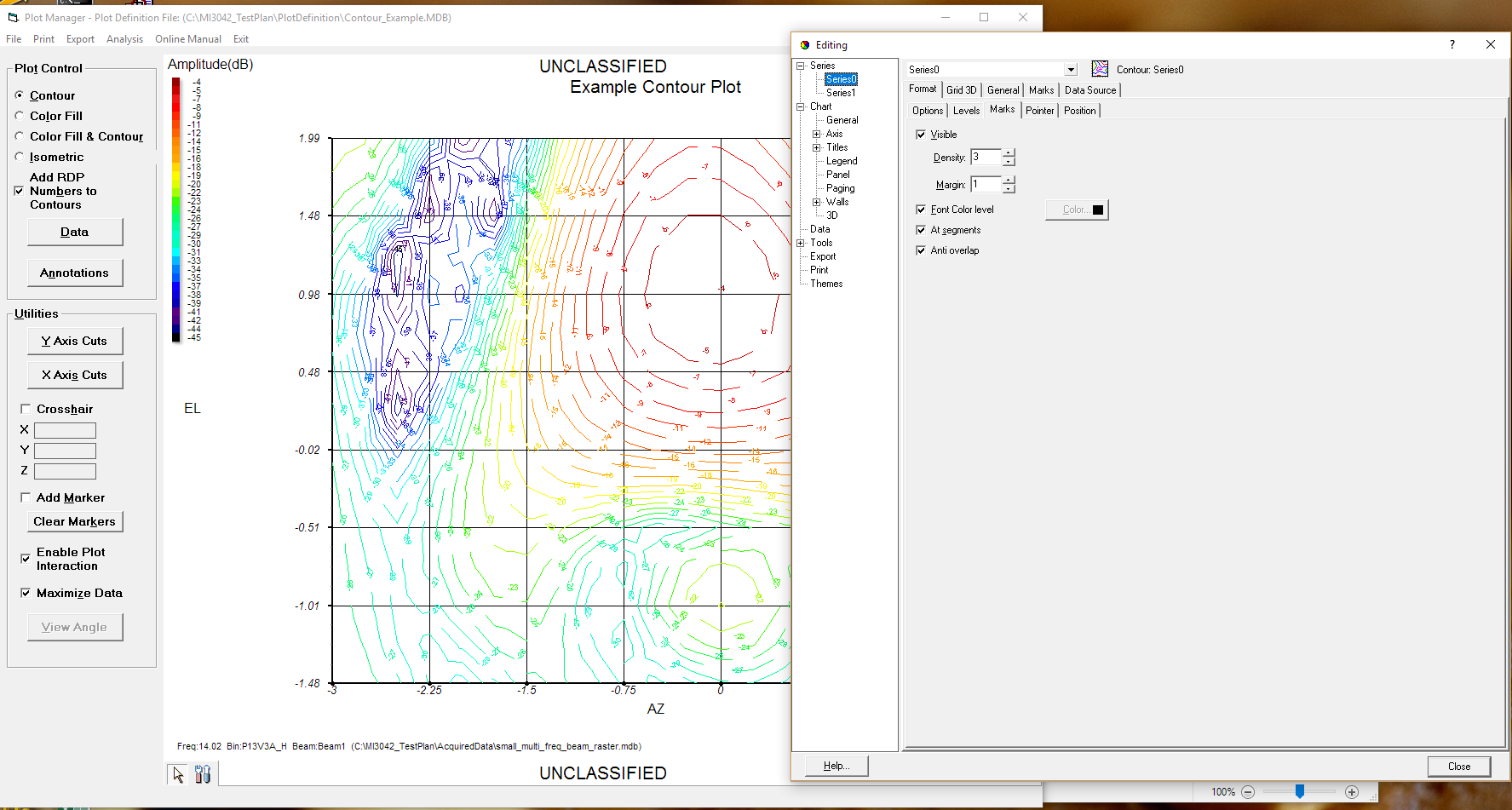

When we updated to TeeChart 2016, I get the breaks in the contours but no numbers
TeeChart 2016 with numbers
TeeChart 2016 - contour with numbers 1.png (226.04 KiB) Viewed 21744 times
TeeChart 2016 with numbers 2
TeeChart 2016 - contour with numbers 2.png (378.55 KiB) Viewed 21745 times
Tee Chart 8 with numbers 1
TeeChart 8 - contour with numbers.png (174.71 KiB) Viewed 21743 times
