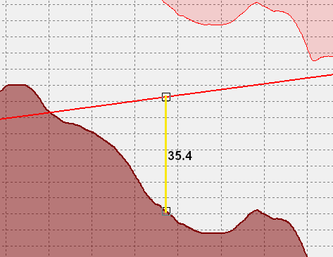

I have two series on my chart, each with a cursor. Is there a way to draw a vertical line between the cursors to indicate the difference between the series values? (ideally, if I could display the value of the difference by the line that would be great).
Something like the yellow line here:
Or is there another way to do this?

You should calculate the Interpolation points and draw the line manually. You could use the AnnotationTool to draw the difference value.
Here a simple example:
