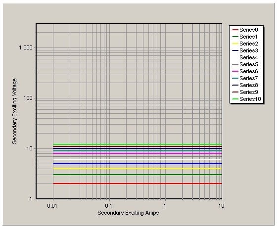

I created a logarithmic chart with solid major and minor grid lines on an ASP page. For some reason, a few of the minor grid lines come out much thicker than the others, even though I have specified the pen width. What can I do to solve the issue? Is this a bug?
Here is my code for setting the chart properties. Please let me know if I need to post the full code.

I've uploaded a screen shot showing the issue with the grid lines. The minor grid lines for 3, 4 and 7 are noticably thicker.

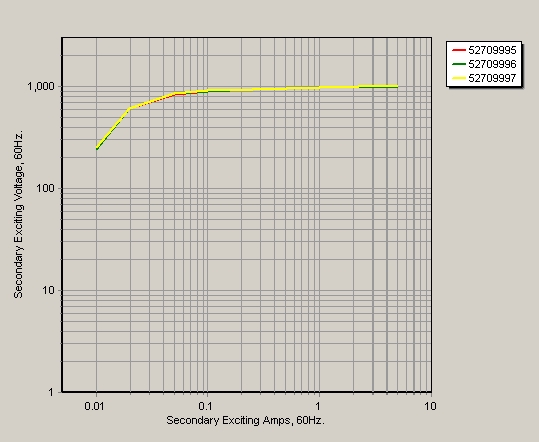

I've previously made a log/log chart in VB without a problem. But right now the problem I'm having is with ASP, not VB. I'm using teechart7.ocx version 7.0.1.4, which is installed on our server.
Here is my code. There are two ASP pages - one to create the chart and save to stream, one page to display the chart.

	Chart1.Axis.Left.MinorGrid.Width = 1
	Chart1.Axis.Left.MinorGrid.Visible = True
	Chart1.Axis.Left.Title.Caption = "Secondary Exciting Voltage"
	Chart1.Axis.Bottom.Automatic = False
	Chart1.Axis.Bottom.Logarithmic = True
	Chart1.Axis.Bottom.SetMinMax 0.005, 10
	Chart1.Axis.Bottom.GridPen.Style = psSolid
	Chart1.Axis.Bottom.GridPen.Color = RGB(153, 153, 153)
	Chart1.Axis.Bottom.GridPen.Width = 1
	Chart1.Axis.Bottom.MinorTickCount = 8
	Chart1.Axis.Bottom.MinorGrid.Style = psSolid
	Chart1.Axis.Bottom.MinorGrid.Color = RGB(153, 153, 153)
	Chart1.Axis.Bottom.MinorGrid.Width = 1
	Chart1.Axis.Bottom.MinorGrid.Visible = True
	Chart1.Axis.Bottom.Title.Caption = "Secondary Exciting Amps"
		For i = 0 to 10
			Chart1.AddSeries(scLine)
			Chart1.Series(i).Pen.Width = 2
			Chart1.Series(i).AddXY 0.01, i+2, "", clTeeColor
			Chart1.Series(i).AddXY 0.02, i+2, "", clTeeColor
			Chart1.Series(i).AddXY 0.05, i+2, "", clTeeColor
			Chart1.Series(i).AddXY 0.1, i+2, "", clTeeColor
			Chart1.Series(i).AddXY 0.25, i+2, "", clTeeColor
			Chart1.Series(i).AddXY 0.5, i+2, "", clTeeColor
			Chart1.Series(i).AddXY 1, i+2, "", clTeeColor
			Chart1.Series(i).AddXY 5, i+2, "", clTeeColor
			Chart1.Series(i).AddXY 10, i+2, "", clTeeColor
		Next
  	Response.BinaryWrite (Chart1.Export.asNative.SaveToStream(True))
DisplayLogChart.asp
<%@LANGUAGE="VBSCRIPT" CODEPAGE="65001"%>
<%Option Explicit%>
<!--#include file="../TChartConsts.vbs" -->
Dim ServerPath
If Request.Servervariables("LOCAL_ADDR")="127.0.0.1" Then
      ServerPath="localhost"
Else
      ServerPath=Request.Servervariables("LOCAL_ADDR")
End If
<html>
<META HTTP-EQUIV="Expires" CONTENT="0">
<script language="VBScript">
Sub Window_onLoad()
	TChart2.Import.LoadFromURL("http://<%=ServerPath%>:8080/CTTestRecords/CreateLogChart.asp")
End Sub
Sub TChart2_OnAfterDraw()
End Sub
</script>
<head>
<title>Logarithmic Chart Example</title>
</head>
<body>
<p>
<object
   id="TChart2"
   width="550"
   height="450"
   type="application/x-oleobject"
   hspace="0"
   vspace="0"
   classid="CLSID:FAB9B41C-87D6-474D-AB7E-F07D78F2422E"
   CODEBASE="http://clwflfs01cige:8080/teechart7.cab#Version=7,0,0,0">
</object>
</p>
</body>
</html>
