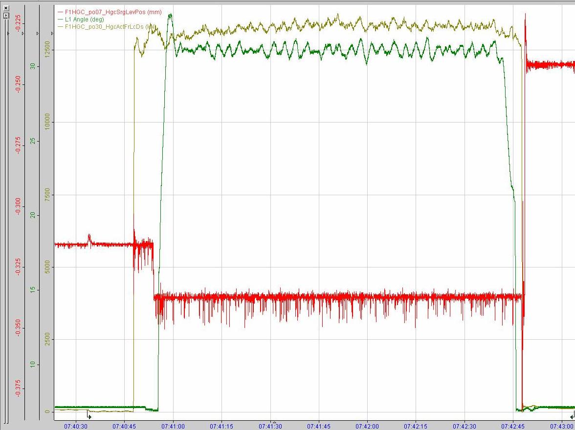

Hi! I'm developing an application using your example of multiple axis as model. I was doing so fine up to now.
The graphs should look like the one in the attachment.
The problem with zooming is as follows: If you zoom any section in the graph, x axis is zoomed but
y axis do not respond to zoom.
I think I should do that by code, but mousedown and mouseup event do not fire when I zoom in the
graph.
I've attached a simplified version of the code. Hope some one could help me.
O. Molina

                                tChart1.Axes.Custom[i].SetMinMax(tChart1.Axes.Custom[i].CalcPosPoint(StartY),tChart1.Axes.Custom[i].CalcPosPoint(e.Y));
                        tChart1.Axes.Bottom.SetMinMax(tChart1.Axes.Bottom.CalcPosPoint(StartX), tChart1.Axes.Bottom.CalcPosPoint(e.X));
                        for (int i=0; i<tChart1.Axes.Custom.Count; i++)
                            tChart1.Axes.Custom[i].Automatic = true;
                        tChart1.Axes.Bottom.Automatic = true;
                        tChart1.Refresh();
                DrawZoomRect = false;
        void  tChart1_MouseMove(object sender, MouseEventArgs e)
            if (DrawZoomRect)
                tChart1.Invalidate();
                tChart1.Graphics3D.Brush.Visible = false;
                tChart1.Graphics3D.Rectangle(StartX, StartY, e.X, e.Y);
        void  tChart1_MouseDown(object sender, MouseEventArgs e)
            if (e.Button == MouseButtons.Left)
                StartX = e.X;
                StartY = e.Y;
                DrawZoomRect = true;
