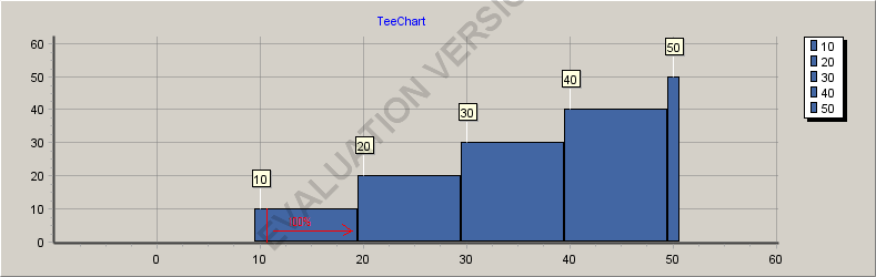

I found a bug on a histogram plot. Whenever the range on bottom axis is changed manually, the entire histogram bars are shifted and misaligned with marks any longer.
In the following run as-is example, I set min and max value for the bottom axis. Then I see two problems/bugs.
1. Bars are shifted to left. eg. The x value for the 1st bar from left to right should be 10, but it looks like 0 on the chart. (BTW, marks are rendered correctly, though) That is, bars should be rendered correctly, aligned with its corresponding marks.
2. Always, the last bar width is way wider than the other bars.
I would appreciate if you can tell me how to fix them or if there is any workaround to resolve these issues.

Post by Jonathan » Fri Jul 23, 2010 3:21 pm
1. I can't comment the line b.setBarWidthPercent(100) since my plot is HISTOGRAM, not pareto.
2. What you suggested doesn't work. Here is similar codes as above for run as-is. In this code, I changed BottomMax=60, setCustomBarWidth=10, and set BottomIncrement=10(Optional, but it makes sense since histogram bar has same barWidth) to see more problems clearly. If you run the code below, you will see the following problems.
Problem 1. the width of the last bar is always smaller than the other bars width.
Problem 2. all bars except the last one are displaced as you can see the marks are not in the middle of bars.
Problem 3. not this example plot, but I can see a problem with another histogram, where bar width is not integer, but double. The data in histogram plot are distorted by casting double bar width to integer in order to use setCustomBarWidth(int)

I see the labels aligned with their correct axis value. The problem is that, having barWidthPercent as 100, the right side of the each bar is changed and it moves to the next bar left side. That's why they look wrong.
What you could do to correct it would be setting a barWidth of the same size that the distance from axis value 10 and 20:
        b.setCustomBarWidth(b.calcXPos(1) - b.calcXPos(0));
