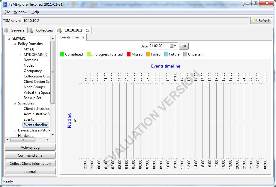

I have downloaded last version teechart for java. But It's evaluation version. Why? Previous version was correctly

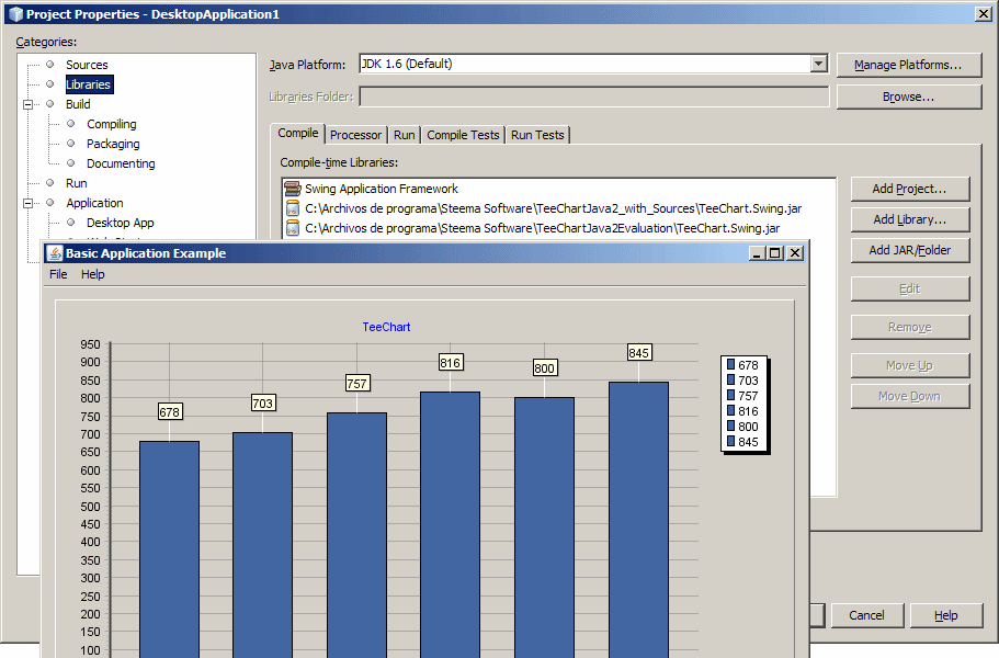

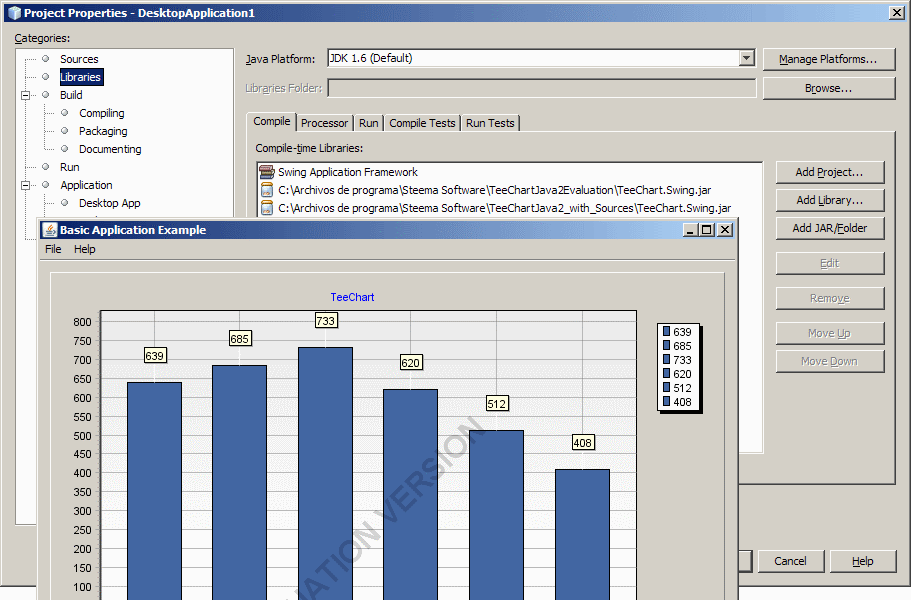

Re: Evaluation
Hi Dimitry,
I still think it has to be something with the paths, somehow. What IDE are you using?
Here, I've just downloaded both the Evaluation (TeeChartJava2Evaluation.zip) and the Pro version (TeeChartJava2_with_Sources.zip) and I can show/hide the EVALUATION text simply changing the order of the paths in a NetBeans application: The test application only creates a Bar series and fills it with some sample values.
Re: Evaluation
My screenshot is evidence too and I downloaded TeeChartJava2_with_Sources.zip. I use Eclipse (Helios).
Previous version is correctly

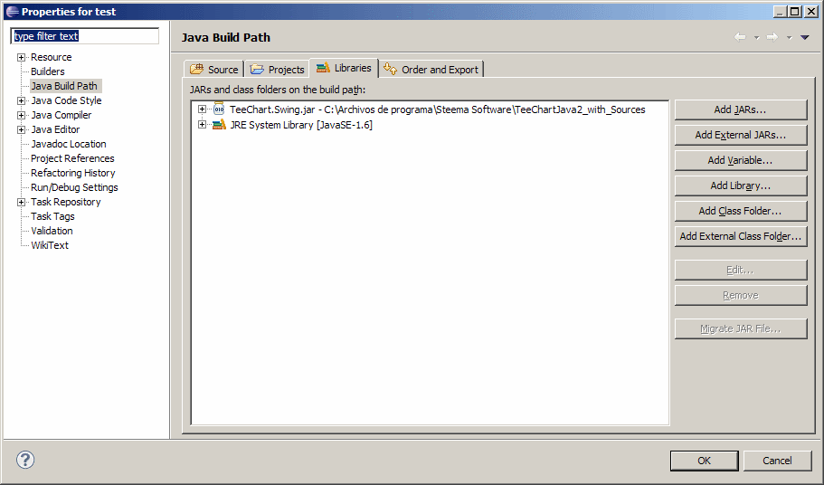

Re: Evaluation
Hi Dimitry,
The question is that, as you'll understand, we need to reproduce the problems here in a solid way so we can study why it is happening.
In Eclipse Helios and the following application I see this: In the case of Eclipse, I've seen that having both the eval and the Pro .jar in the list (ordered with your preference) doesn't seem to be enough and the "evaluation" text is always shown. So I have to remove the eval .jar from the library list to show the chart without the text. Could you please check it.
Re: Evaluation
Yeray, I'm using SWT version. Your examples with Swing
Re: Evaluation
Hi Dimitry,
Ok. You are right. It seems that the TeeChart.SWT.jar uses the wrong ERMode.java. We'll try to fix it asap (TJ71015452).
However, I can link the SWT sources instead of the jar and it works fine. If you have problems with it, don't hesitate to let us know.
