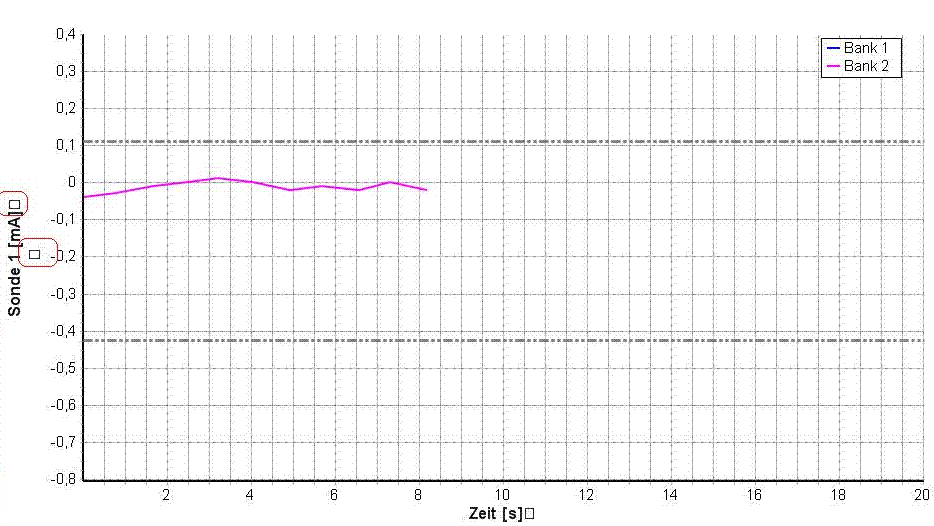

i am using Tchart component in my project.Special characters([]) are displayed at end of Axis titles.This is happening only German windows XP version.
please let me know how to avoid this.

vijay wrote:i am using Tchart component in my project.Special characters([]) are displayed at end of Axis titles
I've tried the following code in both Swing and SWT but I can't reproduce the problem here in a Spanish machine. Does it reproduce the problem for you?

vijay wrote:This is happening only German windows XP version.
Do you mean you've tried the same in another machine and it doesn't happen?
I also see that the image looks like an scanned paper or something similar. Doe the problem only happen when you print the chart or also in your application?

special characters are appeared in German window XP version ( according to my investigation).In other Os It's working fine.
this problem is occurring both in printing the chart and also in the application.

Left Axis text "Sonde 1 [mA]\n ". I added \n to avoid overlapping of title with axis labels ( which was suggested by you).
Bottom Axis text "Zeit [s]".
In the both cases ( both axises) extra special character is appeared in German OS systems.In others It is ok.

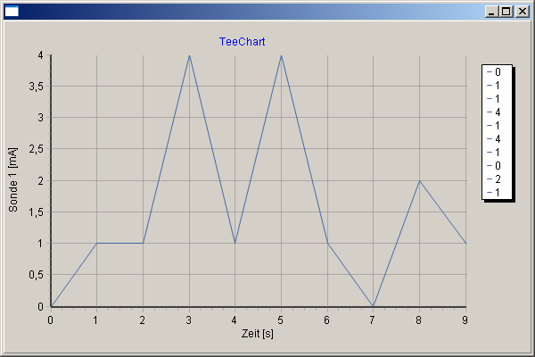

I've installed a fresh German WinXP SP3 32bit + the latest Eclipse Classic + the latest Java SDK + TeeChart Java v2.0.2.271 in a virtual machine.
I've tried both the application you attached here and a simpler version of it with the following code and I can't see the strange characters.

	    tChart1.getAxes().getLeft().getTitle().setText("Sonde 1 [mA]\n ");
	    tChart1.getAxes().getBottom().getTitle().setText("Zeit [s]");
You could try updating your eclipse and java.
