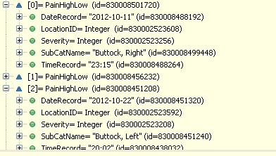

Where PHL contains data such as:

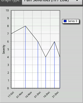

But I get a result like this:
So the questions are:
  • Can HighLow have a TimeSeries
    Why does the X axis show the string rather than the date (I was hoping the string would appear in place of 'Series 0')
    Can there be more than 1 HighLow series per chart, or does it need to page (this app would have n number of series)
Many thanks

DaveSav wrote:Is it possible to create a HighLow chart with a timeseries as the x axis?
DaveSav wrote:Can HighLow have a TimeSeries
DaveSav wrote:Why does the X axis show the string rather than the date
Yes, of course. In your code, you are adding the points with label (PHL.get(i).getName()). Having a point with a label (and while the bottom axis labels style is the default "AUTO") makes the bottom axis to show the labels instead of the values. To change it, you just have to force the bottom axis labels style to "VALUE":
tChart1.getAxes().getBottom().getLabels().setStyle(AxisLabelStyle.VALUE);
DaveSav wrote:I was hoping the string would appear in place of 'Series 0'
Do you mean you want the point labels (PHL.get(i).getName()) to be shown in the legend?
If I comment the following lines I get the values and labels in the legend, without checkboxes:
//tChart1.getLegend().setLegendStyle(LegendStyle.SERIES);
//tChart1.getLegend().setCheckBoxes(true);
Then, if I add the following line, I get only the labels, but still without the checkboxes:
tChart1.getLegend().setTextStyle(LegendTextStyle.PLAIN);
I'm afraid it's not possible to have the list of points in the legend with checkboxes. When the checkboxes are active the legend style changes automatically to show the list of series. If you want to show/hide a point, you have to do it manually with the setnull function.
DaveSav wrote:Can there be more than 1 HighLow series per chart, or does it need to page (this app would have n number of series)
Yes, why not? Ie:

This is the data which is being sent via
hl.add(dt, (double)PHL.get(i).getSeverity(), PHL.get(i).getName());
10/11/12	8	Buttock, Right
10/11/12	7	Buttock, Right
11/4/12		8	Buttock, Right
11/25/12	6	Buttock, Right
12/8/12		4	Buttock, Right
12/23/12	6	Buttock, Right
1/1/13		4	Buttock, Right
which appears to be in month/day/year format.

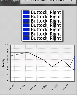

And this is the chart produced:
You'll notice that only 1 item has a potential Hi/Low value.
As this would be user generated data, it would be quite common for a date to have only 1 value assigned to it, or it could have more than 2 values assigned to it.
With this in mind, here are my follow up questions:
  • Why do you think that the values for 10/11/12 aren't displaying in a Hi-Low format
    Should I further prepare the data in PHL before providing it to the chart? I.e. if a date has 5 values against it, should I parse it so that only the highest and lowest values are sent
    If a date only has 1 value against it, how should I present that to the chart - the user would still want to see that data
Many thanks for your help to date.

DaveSav wrote:Why do you think that the values for 10/11/12 aren't displaying in a Hi-Low format
If I understand it correctly, you've added two points at 10/11/12, one with High value 8 and the next with High 7.
You should do it as shown above, adding each point with High and Low values.

This is the graph produced:
I am happy with the graph, but I can't figure out how to configure the Legend. It should show the series name only once. Is this possible?
Re: HighLow chart with TimeSeries
Post by Yeray » Wed Jan 09, 2013 3:00 pm
Hi Dave,
Since you added the points with label (actually the same "Buttock, Right" label for all the points) the default legend style shows these labels when present.
If you want to show the series name, you can force it with this:
Note you also have to set your series title, ie:
hl.setTitle("Buttock, Right");
