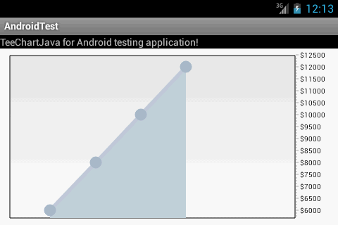

I see you have hidden the Walls:
         chart.getWalls().setVisible(false);
If I comment the line above, with this code on my Activity onCreate method, I get the chart below:
		LinearLayout group = (LinearLayout) findViewById(R.id.chart_layout);
		double[] xvals = {5, 10, 15, 20};
		List<double[]> xvalues = new ArrayList<double[]>();
		xvalues.add(xvals);
		double[] yvals = {6000, 8000, 10000, 12000};
		List<double[]> yvalues = new ArrayList<double[]>();
		yvalues.add(yvals);
		GraficaLineas grafica = new GraficaLineas(xvalues, yvalues, this, "Enero", 2);
		TChart tChart1 = grafica.getGrafica();
		group.addView(tChart1);
walls visible.png (9.04 KiB) Viewed 18666 times

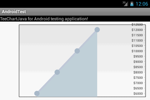

Then, it seems the space on the left is actually the space for the left axis labels, that you have moved to the right with:
			chart.getAxes().getLeft().setRelativePosition(100);
But you could use the right axis instead:
			chart.getSeries(0).setVerticalAxis(VerticalAxis.RIGHT);
And set the right axis instead of the left axis:
	void axesStyle(double tamañom, double tamañm) {
		if (call == 1 || call == 3) {
			chart.getAxes().getRight().setAutomatic(false);
			chart.getAxes().getRight().setStartPosition(0);
			chart.getAxes().getRight().setIncrement(1);
			chart.getAxes().getRight().setMaximum(tamañom + 1);
			chart.getAxes().getRight().getAxisPen().setVisible(false);
			chart.getAxes().getRight().getGrid().setVisible(false);
			//chart.getAxes().getRight().setRelativePosition(100);
		if (call == 2) {
			chart.getAxes().getRight().setMaximum(tamañom + 500);
			if (tamañom > 300) {
				chart.getAxes().getRight().setMinimum(tamañm - 300);
			} else {
				chart.getAxes().getRight().setMinimum(tamañm);
			chart.getAxes().getRight().getLabels().setValueFormat("$");
			//chart.getAxes().getLeft().setRelativePosition(100);
right axis.png (8.4 KiB) Viewed 18649 times

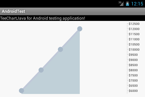

Then, hiding the walls again I get this:
right axis walls hidden.png (7.82 KiB) Viewed 18655 times
Is that what you wanted?
You can also try playing with the Panel Margins, setting negative values.

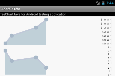

Re: TeeChart for android Area issues
Post by Yeray » Mon Jan 28, 2013 1:47 pm
jesus.navarro wrote:Hi Yeray,
About the Area Brush, I've tried
chart.getWalls().setVisible(true);
and it's still not working.
Sorry, I haven't been able to reproduce the problem with the Area Brush. It seems to be correctly drawn for me here with v2012.0808. Is this one the version you are using?
Making the Walls visible was just to notice how the space on the left seems to be the same the axis labels have reserved.
jesus.navarro wrote:And about the Axis, I've tried setting the right axis, but I need the ticks to be displayed after the labels and setting the right axis the ticks are displayed before the labels. Is there a way to set the order to display ticks and labels int right axis?.
I think the easier way to achieve this is to use a custom axis because only the regular axes (left, right, top, bottom) calculate and reserve the space the labels need to be drawn.
To do so, you could create and assign the custom axis before calling your axesStyle function:
			Axis myAxis = new Axis();
			chart.getAxes().getCustom().add(myAxis);
			series.setCustomVertAxis(myAxis);
			axesStyle(series.getMaxYValue(), series.getMinYValue());
And then, the axesStyle function could be slightly different, to configure this custom axis instead of the default left or right one:
		Axis myAxis = series.getCustomVertAxis();
			myAxis.setAutomatic(false);
			myAxis.setStartPosition(0);
			myAxis.setIncrement(1);
			myAxis.setMaximum(tamañom + 1);
			myAxis.getAxisPen().setVisible(false);
			myAxis.getGrid().setVisible(false);
			myAxis.setRelativePosition(100);
		if (call == 2) {
			myAxis.setMaximum(tamañom + 500);
				myAxis.setMinimum(tamañm - 300);
			} else {
				myAxis.setMinimum(tamañm);
			myAxis.getLabels().setValueFormat("$");

This doesn't change the result for the particular charts I'm drawing, at least in respect to the issues reported here.
Find below the full code I'm using:
