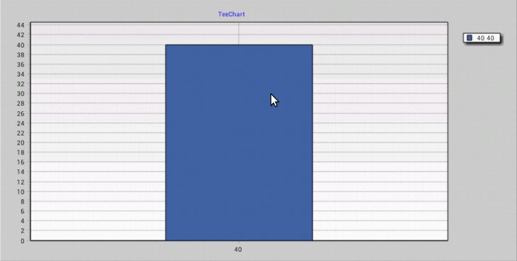

I have created application which use this Bar chart.To show issue to you I have also created Demo application and Chart related snippet is as follow:

Above snippet's result is shown in below image :
Please reply me what to do if I want to show mark when there is only "Single Bar" in Chart ?

Post by Yeray » Mon Jan 28, 2013 2:02 pm
You can set the Marks visible or invisible with the following function:
bar.getMarks().setVisible(true);
And you could check if your series has one value or several with the getCount() function:
bar.getMarks().setVisible(bar.getCount()==1);
