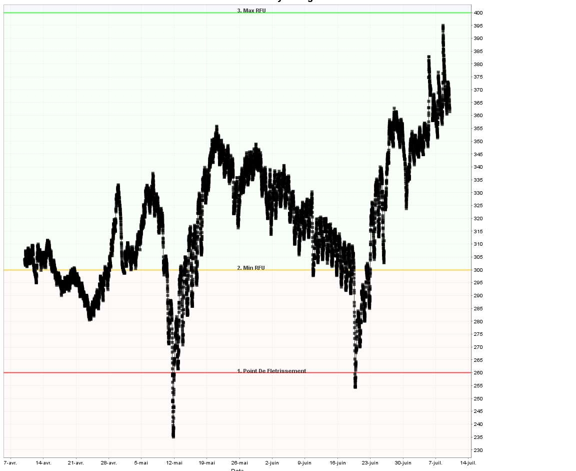

I want to draw shape orto fill rectangle on the chart.
It is used as limits.
like this :
I am using the android version.
I was able to draw a line :

I was able to draw a rectangle (only the border, I a not able to fill it with a color)
Point pfrom = new Point(serie2.calcXPos(0), serie2.calcYPosValue(0));
                        Point pto = new Point(serie2.calcXPos(serie2.getCount() - 1), serie2.calcYPosValue(serie2.get(values).min));
                        Dimension d = new Dimension(serie2.calcXPos(serie2.getCount() - 1) - serie2.calcXPos(0), serie2.calcYPosValue(values.get(serie2).min) - serie2.calcYPosValue(0));
                        com.steema.teechart.Rectangle r = new com.steema.teechart.Rectangle(pfrom, d);
                        g.getPen().setColor(Color.YELLOW);
                        g.getPen().setTransparency(70);
                        g.getBrush().setColor(Color.blue);
                        g.rectangle(r);
How I can draw a Shape ?

Post by Yeray » Tue Feb 26, 2013 10:49 am
Make sure the Brush is visible, its gradient invisible, etc:
                g.getBrush().setVisible(true);
                g.getBrush().getGradient().setVisible(false);
                g.getBrush().setTransparency(70);
                g.rectangle(r);
