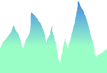

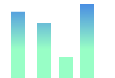

Proper gradient for bars/area
Post by znakeeye » Tue Mar 12, 2013 11:04 pm
http://stackoverflow.com/questions/1415 ... tchart-bar
Was TJ71016478 fixed?
Also, I believe this answer is incomplete.
http://stackoverflow.com/questions/1401 ... a-gradient
In your answer, you set the start color to green:
band1.getGradient().setStartColor(Color.green);
What if your maximum value was 350 instead of 675? The color at that point should be yellow, but your series band will produce green in this case. It does not respect min/max:
chart.getAxes().getLeft().setMinimum(0.0);
chart.getAxes().getLeft().setMaximum(675.0);
What I'm trying to do is to get a gradient for my bar and area charts that always shows the same color at a given y-position. This way, the color becomes an indicator of the value.
Imagine if the color at the top was red. It should NOT get painted unless we reach the maximum value.
Nice area :P
Ideally, I would want multiple gradient colors. Not just three!

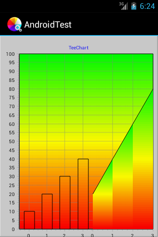

I think I understood what you want to do. See the following code:
		  tChart1.getLegend().setVisible(false);
		  Axis bottom1 = new Axis();
		  Axis bottom2 = new Axis();
		  bottom1.setHorizontal(true);
		  bottom2.setHorizontal(true);
		  tChart1.getAxes().getCustom().add(bottom1);
		  tChart1.getAxes().getCustom().add(bottom2);
		  bottom1.setEndPosition(50);
		  bottom2.setStartPosition(50);
		  Bar bar1 = new Bar(tChart1.getChart());
		  bar1.setCustomHorizAxis(bottom1);
		  bar1.getGradient().setVisible(true);
		  bar1.setGradientRelative(true);
		  bar1.getGradient().setStartColor(Color.green);
		  bar1.getGradient().setMiddleColor(Color.yellow);
		  bar1.getGradient().setUseMiddle(true);
		  bar1.getGradient().setEndColor(Color.red);
		  bar1.getMarks().setVisible(false);
		  Area area1 = new Area(tChart1.getChart());
		  area1.setCustomHorizAxis(bottom2);
		  area1.setOrigin(0);
		  area1.setUseOrigin(true);
		  area1.getAreaLines().setVisible(false);
		  area1.getGradient().setVisible(true);
		  for (int i=0; i<4; i++) {
			  bar1.add((i+1)*10);
			  area1.add((i+1)*20);
		  tChart1.getWalls().getBack().getGradient().setVisible(true);
		  tChart1.getWalls().getBack().getGradient().setDirection(GradientDirection.VERTICAL);
		  tChart1.getWalls().getBack().getGradient().setStartColor(Color.green);
		  tChart1.getWalls().getBack().getGradient().setMiddleColor(Color.yellow);
		  tChart1.getWalls().getBack().getGradient().setUseMiddle(true);
		  tChart1.getWalls().getBack().getGradient().setEndColor(Color.red);
		  tChart1.getAxes().getLeft().setMinMax(0, 100);
		  bar1.setBarStyleResolver(new BarStyleResolver() {
			@Override
			public BarStyle getStyle(ISeries series, int valueIndex, BarStyle style) {
				if (series!=null) {
					Gradient seriesGradient = ((Bar)series).getGradient();
					Color tmpStartColor = null, tmpMidColor = null;
					if (valueIndex > -1) {
						double tmpValue = series.getYValues().getValue(valueIndex);
						if (tmpValue>50) {
							double percent = (tmpValue-50)*2;
							tmpStartColor = calcColorBlend(seriesGradient.getStartColor(), seriesGradient.getMiddleColor(), percent);
							tmpMidColor = calcColorBlend(seriesGradient.getStartColor(), seriesGradient.getMiddleColor(), percent/2);
						else {
							double percent = tmpValue*2;
							tmpStartColor = calcColorBlend(seriesGradient.getMiddleColor(), seriesGradient.getEndColor(), percent);
							tmpMidColor = calcColorBlend(seriesGradient.getMiddleColor(), seriesGradient.getEndColor(), percent/2);
						tChart1.getGraphics3D().getGradient().setStartColor(tmpStartColor);
						tChart1.getGraphics3D().getGradient().setMiddleColor(tmpMidColor);
				return style;
Now, something similar should be done with the Area. Note it could be a little bit more tricky with the Area:
- The PointerStyleResolver is the event that is called each time a point is being drawn. So you will have to set the area pointer visible, and hide it in the event, returning PointerStyle.NOTHING.
- In the drawing process, the area is drawn prior to the pointer, so prior to the PointerStyleResolver. This involves:
* You'll have to play with the indexes to find what value you have to take to calculate what area.
* You'll probably have to set the series gradient colors instead of directly setting the canvas gradient colors.

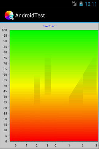

Right. Even the relative gradients in the Bar series are always relative to the maximum value of the series. Right now, there's no property or method to set gradients relative to other values; in your case, relative to the axis scale. This was what I was trying to achieve here.
And I've improved that code a bit. Take a look at it:
	final Color mStartColor = Color.green;
	final Color mMiddleColor = Color.yellow;
	final Color mEndColor = Color.red;
	final int mStartValue = 100;
	private void initializeChart() {
		  tChart1.getPanel().setMarginUnits(PanelMarginUnits.PIXELS);
		  tChart1.getPanel().setMarginBottom(25);
		  bottom1.getGrid().setVisible(false);
		  bottom2.getGrid().setVisible(false);
		  tChart1.getAxes().getLeft().getGrid().setVisible(false);
		  bar1.getGradient().setEndColor(mEndColor);
		  area1.setOrigin(0);
		  area1.getLinePen().setVisible(false);
			  bar1.add((i+1)*20);
		  area1.getGradient().setDirection(GradientDirection.VERTICAL);
		  area1.getGradient().setUseMiddle(true);
		  area1.getGradient().setEndColor(mEndColor);
		  area1.getPointer().setVisible(true);
		  double tmpStartValue = area1.getYValues().getValue(1);
		  setGradient(area1.getGradient(), tmpStartValue);
		  tChart1.getWalls().getBack().getGradient().setStartColor(mStartColor);
		  tChart1.getWalls().getBack().getGradient().setMiddleColor(mMiddleColor);
		  tChart1.getWalls().getBack().getGradient().setEndColor(mEndColor);
		  tChart1.getAxes().getLeft().setMinMax(0, mStartValue);
		  bar1.getPen().setVisible(false);
			@Override
				if (series!=null) {
						setGradient(tChart1.getGraphics3D().getGradient(), tmpValue);
				return style;
		  area1.setPointerStyleResolver(new PointerStyleResolver() {
			@Override
			public PointerStyle getStyle(ISeries series, int valueIndex, PointerStyle style) {
				if (series!=null) {
					Gradient seriesGradient = ((Area)series).getGradient();
						double tmpValue = series.getYValues().getValue((valueIndex+2) % series.getCount());
						setGradient(seriesGradient, tmpValue);
				return PointerStyle.NOTHING;
	private void setGradient(Gradient gradient, double value) {
		double mMiddleValue = mStartValue/2;
		if (value>mMiddleValue) {
			double percent = (value-mMiddleValue)*2;
			gradient.setStartColor(calcColorBlend(mStartColor, mMiddleColor, percent));
		else {
			double percent = value*2;
			gradient.setStartColor(calcColorBlend(mMiddleColor, mEndColor, percent));
		value /= 2;
			gradient.setMiddleColor(calcColorBlend(mStartColor, mMiddleColor, percent));
		else {
			gradient.setMiddleColor(calcColorBlend(mMiddleColor, mEndColor, percent));
	private Color calcColorBlend(Color end, Color start, double percentage) {
        int tmpA = start.getAlpha() + Utils.round((end.getAlpha()-start.getAlpha()) * percentage / 100);
        int tmpR = start.getRed() + Utils.round((end.getRed()-start.getRed()) * percentage / 100);
        int tmpG = start.getGreen() + Utils.round((end.getGreen()-start.getGreen()) * percentage / 100);

However, I'm afraid this is still not perfect:
When the bar/area value is below middleValue, 50 in the case above, it works fine because we just have to find the start and middle colors appropriate to the percentages, both between yellow and red.
However, when the bar/area value is above middleValue, the shape to draw isn't regular: it should be a shape from the value to 50, with a startColor according to the value percentage and a full yellow middleColor. And the second shape would be a rectangle going from yellow 50 to red 0.
znakeeye wrote:I believe there is a simple solution to get this right. This works:
    if (dir == GradientDirection.VERTICAL) {
        g = new LinearGradient(0, /*rectangle.y*/0, 0, rectangle.getBottom(),
            colors, null,
            Shader.TileMode.CLAMP);
If you ask me, the above is the correct way to apply a gradient on any chart. Perhaps you should add another GradientDirection enum that does exactly this?
In what code example do you find this change makes a better gradient?
