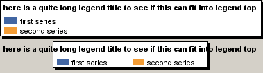

Post by Yeray » Mon Feb 21, 2011 12:16 pm
Hi Jonathan,
I can see the Bug #1 you reported so I've added it to the defect list to be fixed in future releases (TJ71015403).
Regarding the Bug #2, I don't see any difference between default alignment (right) and top alignment. Here is my result with NetBeans 6.9.1:

2) The size of blue and orange images got a bit smaller when the position is top/bottom, when compared to left/right. I can even see the a little difference on the image you posted.

Jonathan wrote:2) The size of blue and orange images got a bit smaller when the position is top/bottom, when compared to left/right. I can even see the a little difference on the image you posted.
You are right. I can see a difference of about two pixels. I've added it to the defect list to be fixed in future releases (TJ71015407).
