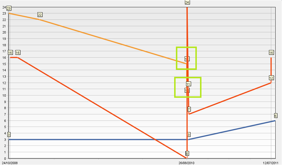

I would like the markers stay in front of all lines, but this is not happening, the markers are becoming overlapped by the lines.
I searched here on the forum and not found similar question.
Below is the image attachment that better represents the question.
Is there any way to show all the marks in front the lines?

This is because the marks are drawn at the same time the corresponding series is drawn.
An onTop property (accessible through getOnTop & setOnTop methods) to control it will be present in the next TeeChart Java v3.
