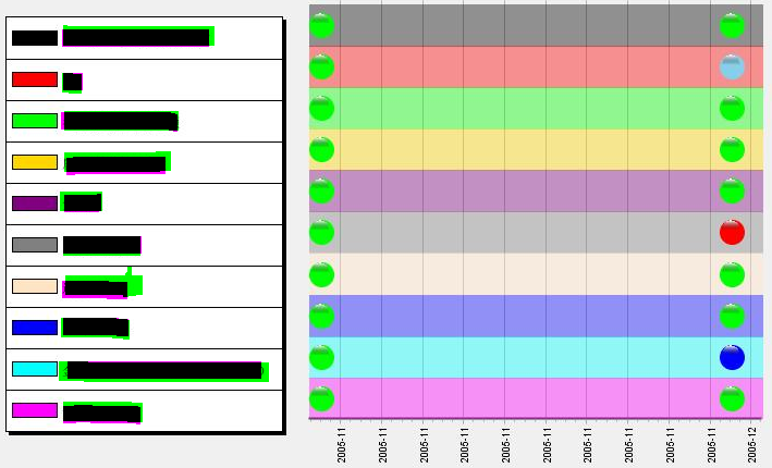

I 'm using bubble series, and the current effect is shown below, where the labels lie in the left of the bubbles. But I want the labels to be in the middle of the corresponding bubbles.
I browsed the topics in the forum and didn't find any related questions. Actually, I found few question about bubble series. I also browsed the Teechart tutorial but found few information about this.
Much appreciate if anybody had advises.
Current effect

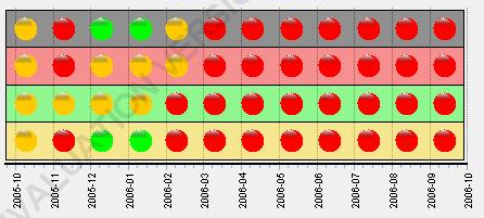

Pls, in the above picture, the X-labels are from 2005-10 to 2006-9. And in fact, the bubble series are from 2005-11 to 2006-10. Which means that the label starts one month early than the bubble date. I tried this method:
ch1.getChart().getPanel().setMarginLeft(15);
and only got this:
In this picture, the label "2005-10" is needless, and the labels stand on the left of the corresponding bubbles.

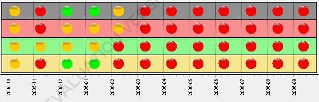

As an experimet, I added only three colums of series, whose x-labels are: 2006-10, 2006-09 and 2006-08. Resulted in:
In this case, I used this method to ensure there are only three x-labels:
ch1.getAxes().getBottom().getLabels().setSeparation(500);
Without setSeparation() method or smaller separation value, there'll be several repeated labels, say "2006-07,2006-08,2006-08,2006-09,2006-09,2006-10".

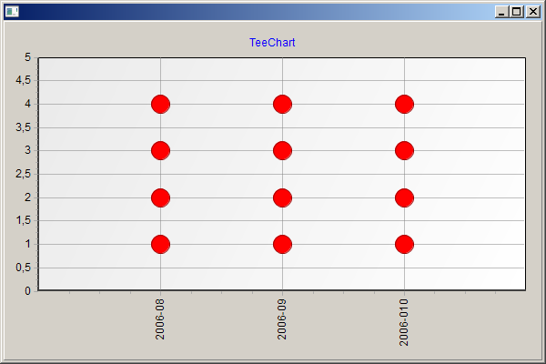

Hello Helen,
Trying to reproduce your situation, here it is the result I'm getting with the code below:
	private static void initializechart() {
        tChart1.getLegend().setVisible(false);
        Bubble bub1 = new Bubble(tChart1.getChart());
        for (int col=1; col<4; col++)
        	for (int row=1; row<5; row++)
            	bub1.add((double)col, (double)row, 0.2, "2006-0"+(col+7), Color.red);
        tChart1.getAxes().getLeft().setMinMax(0, 5);
        tChart1.getAxes().getBottom().setMinMax(0, 4);
        tChart1.getAxes().getBottom().getLabels().setAngle(90);
I'm probably doing something different than you. Could you please try to modify the code above so we can be reproduce the problem here?

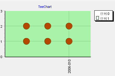

And got the result:
Did I add it improperly?

Hello Helen,
You are adding a second series to give color to the background. Note that the series need two axes (or three if 3D series) to be drawn, and these axes are formatted according to the series linked to them. This is affecting the behaviour in your code.
However, you can color your background using the ColorBand tool instead of an HorizArea series. This tool doesn't affect the axes labels. Here it is the code snipped:
	      // Add background color
	      ColorBand band1 = new ColorBand(tChart1.getChart());
	      tChart1.getTools().add(band1);
	      band1.setAxis(tChart1.getAxes().getLeft());
	      band1.setStart(0);
	      band1.setEnd(3);
	      band1.getBrush().setColor(Color.green);
	      band1.getPen().setVisible(false);
	      band1.setTransparency(90);

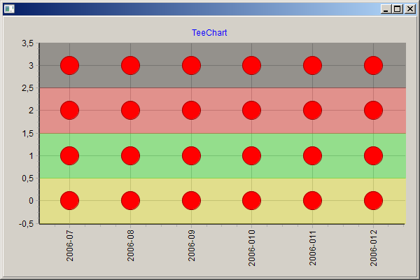

I still think the best option is using ColorBand instead of a series. Note that in the example above we've set the tool to use the left axis and we've set the Start and End values for the tool to be drawn horizontally. If we set the tool to use the bottom axis, the ColorBand will be drawn vertically as the Start and End values would be from the bottom axis.
To achieve something similar to your initial picture, I'd use as many ColorBand tools as rows of points. Here it is a simple example:
	private static void initializechart() throws ParseException {
	    Bubble bubble = new Bubble(tChart1.getChart());
	    int nCols = 6;
	    int nRows = 4;
	    for (int col = 0; col < nCols; col++) {
	        for (int row = 0; row < nRows; row++) {
	            bubble.add((double) col, (double) row, 0.2, "2006-0" + (col + 7), Color.red);
	            if (col == 0) {
	            	ColorBand band = new ColorBand(tChart1.getChart());
	      	      	tChart1.getTools().add(band);
	      	      	band.setAxis(tChart1.getAxes().getLeft());
	      	      	band.setStart(row-0.5);
	      	      	band.setEnd(row+0.5);
	      	      	band.getPen().setVisible(false);
	      	      	switch (row) {
	      	      	case 0:
	      	      		band.getBrush().setColor(Color.yellow);
	      	      		break;
	      	      	case 1:
	      	      		band.getBrush().setColor(Color.green);
	      	      		break;
	      	      	case 2:
	      	      		band.getBrush().setColor(Color.red);
	      	      		break;
	      	      	case 3:
	      	      		band.getBrush().setColor(Color.black);
	      	      		break;
	      	      	band.setTransparency(70);
	      tChart1.getAxes().getLeft().setMinMax(-0.5, nRows-0.5);
	      tChart1.getAxes().getBottom().setMinMax(-0.5, nCols-0.5);
