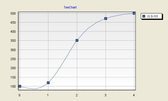

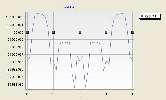

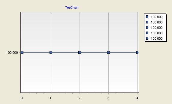

Hello, i find a problem with Line graph.
the code is as follows:
the result is in the attachment "smooth.bmp"
when i remove the line " series.setSmoothed(true);" everything is fine.
the result is in the attachment "no smooth.bmp".
Moreover, if i change
" series.add(100000);
series.add(100000);
series.add(100000);
series.add(100000);
series.add(100000);"
to
series.add(100);
series.add(120);
series.add(350);
series.add(470);
series.add(500);
everything is fine too. Please see the attachment "3.bmp".
So I think there is some problem with the"setSmoothed".

Re: the smooth problem of Line
Post by Yeray » Tue Sep 10, 2013 2:48 pm
You are right. When you have a Line series with several equal values, the SmoothingFunction (or the Smoothed property) doesn't calculate the values correctly, so I've added it to the wish list to be revised for further releases (TJ71016716).
In the meanwhile, I can only think on checking when this situation happens and disable the Smoothed property.
