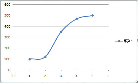

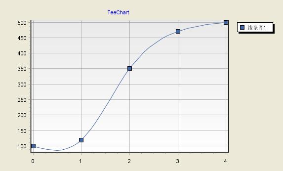

2. teechart draw the first point of one series when x=0, (please refer to teechart.jpg)
but in excel, the first point is darwed when x=1. (please refer to excel.jpg)
Does there exist some method to change this behavior in teechart.
Sure, use add method with X values starting at any value you like, for example:
        for (int i = 1; i < 10; i++) {
            line1.add(i,i*i);
