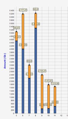

How does the position change at the bar?
I would like to make displace to right (or left).
Dmitry

And How tp solve problem with the overlap mark?

Dmitry wrote:And How tp solve problem with the overlap mark?
Which exact TeeChart version are you using? Latest versions include OnTop property for SeriesMarks, true by default, that solves that problem, for example:
  series1.getMarks().setOnTop(true)
As you can see at the version info page, this property (feature request TJ71015677) was added in Build 3.0.1.001 from November 2011.
