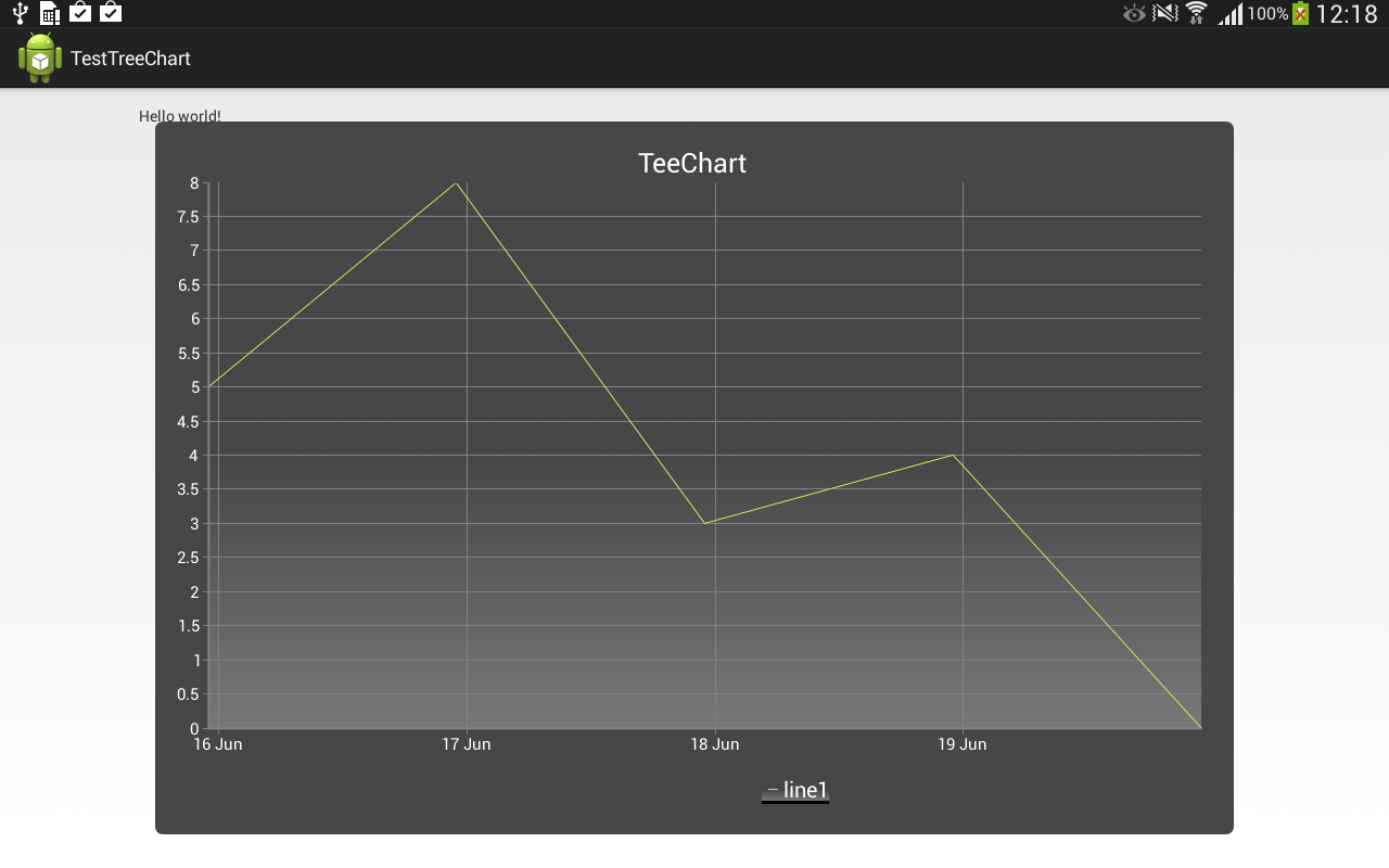

Post by Yeray » Wed May 21, 2014 11:11 am
Hello Saman,
This is how it looks for me. How does it look for you?

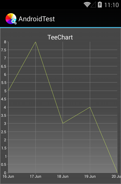

This is what I get (also please note that I am in UK different time zone)
I have attached the photo

Post by Yeray » Wed May 21, 2014 12:22 pm
Hello Saman,
This sounds similar to this:
http://bugs.teechart.net/show_bug.cgi?id=420
Could you please show us how do you set your layout?
If you are sharing the LinearLayout for texts and the chart, can you please try using an independent LinearLayout without margins for the Chart?
