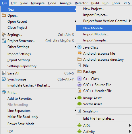

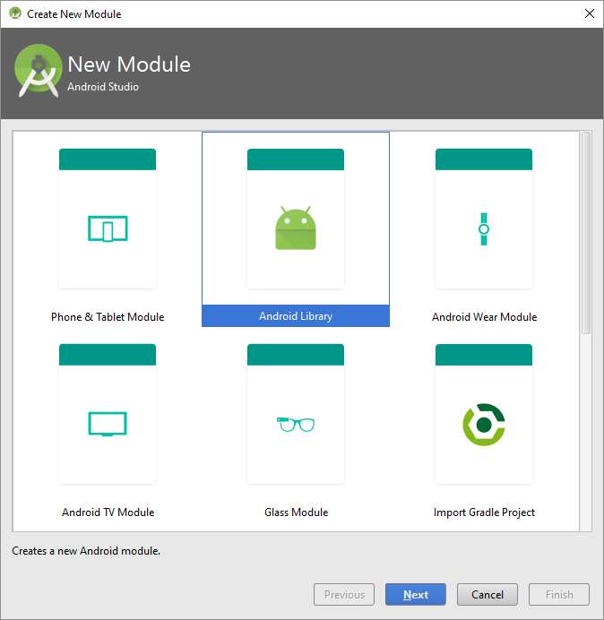

1. Create a new project in Android Studio. I've created a simple app targeting API 15+, with a blank activity leaving the default name "My Application".
2. Add a new library module to the Project Structure:

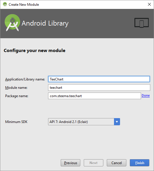

3. Give it a name and a target. I've named it as "TeeChart", "com.steema.teechart" and target API 7+:

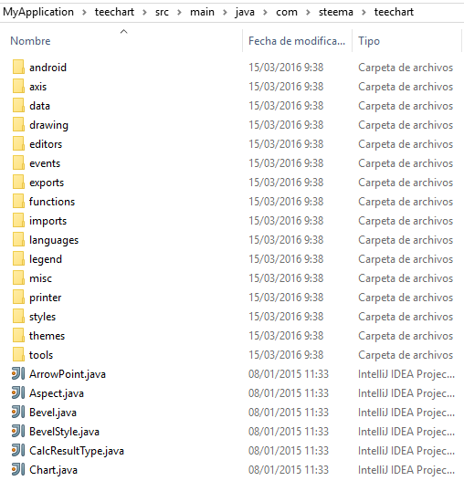

This creates a folder tree under your app "teechart\src\main\java\com\steema\teechart"
4. After installing TeeChart for Android with sources or TeeChart Java Suite with sources, you should find a src.zip containing the sources. Extracting it you'll find the TeeChart Java for Android sources, with a structure similar than the created on the empty module above: "src\Android\com\steema\teechart".
Copy the contents of this path into the path above in your module to have something like this:

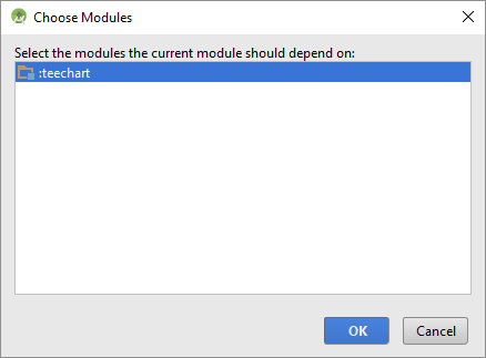

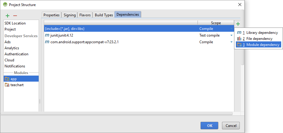

5. At "Project Structure", add the dependency:
Now you should be able to import TeeChart units, so you would be using TeeChart directly from the sources!
