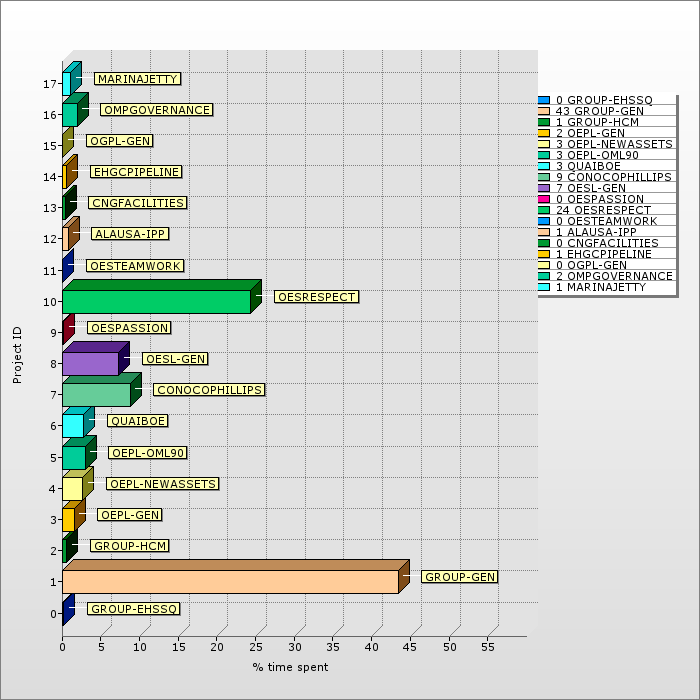

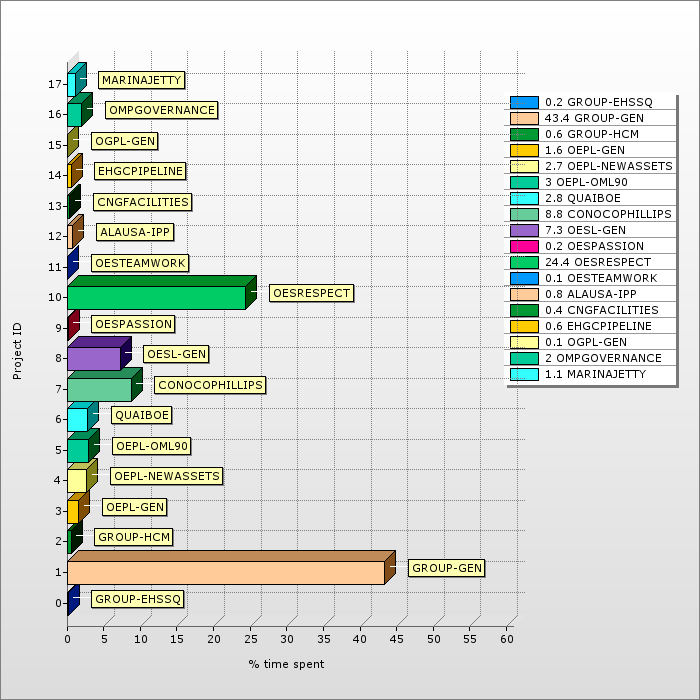

Look at the attached .png files which compare the quality of charts from the 2010 version and your very latest (May-2014) version. You can see that the chart Legend in the 2014 version shows the lines separating the legend texts actually touching the texts. The chart from the 2010 version is of better quality.
- Legend lines are not adequately spaced for the legend texts
- TChart2014-Sample.png (66.68 KiB) Viewed 131163 times
- Crisp and clear Legend -lines are optimally spaced
- TChart2010-Sample.png (71.4 KiB) Viewed 131134 times
Re: Save image to file fails
Thanks for reporting this.
We've made a few changes and fixed this problem with the legend.
I'll send you the new sources to the mail account you have registered in this forum.
