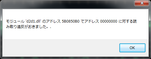

But when I add data two TFastLineseries, some AV error like attachment arose.
Thread error.png (30.79 KiB) Viewed 21180 times

Post by elmec » Tue Jun 03, 2014 3:07 am
If I mask "Series->Add ", it seems OK..
What is d2d1.dll, is it a part of Teechart?

elmec wrote:But when I add data two TFastLineseries, some AV error like attachment arose.
We'd need a simple example project we can run as-is to reproduce the problem here to further investigate this.
elmec wrote:If I mask "Series->Add ", it seems OK..
No, it isn't.
