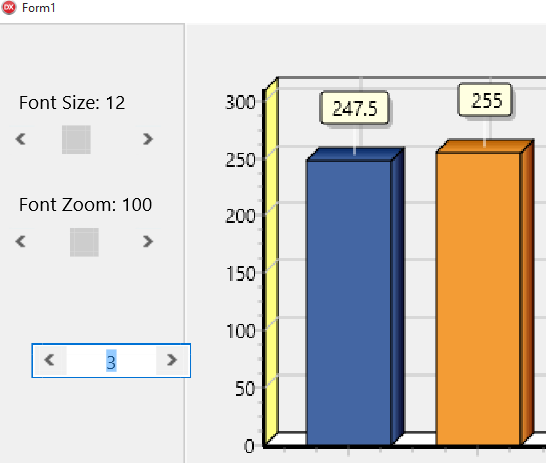

I notice now that the font quality on the axis on tchart on FMX is not very good (compared to how it was in XE6)
especially when smaller font size is used
and it really shows up badly pixaleted when you make the form scale larger (i.e if its on a tlayout and you set the scale of that higher than 1)

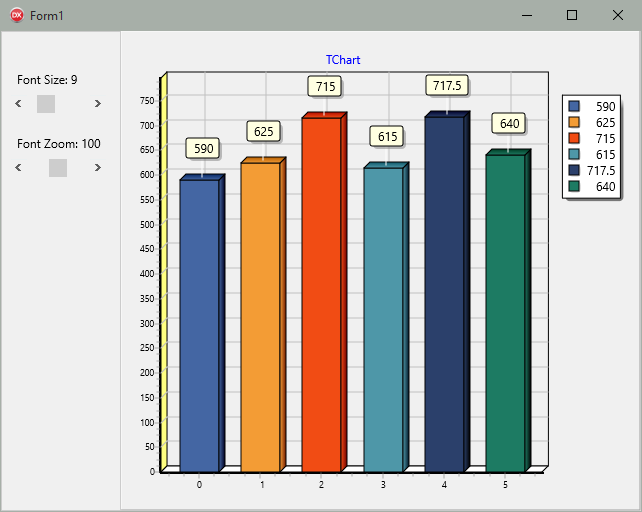

I've made a simple test and this is how it looks with RAD 10 and TeeChart v2015.16:
FMXFontTest.zip
(1.64 KiB) Downloaded 1344 times

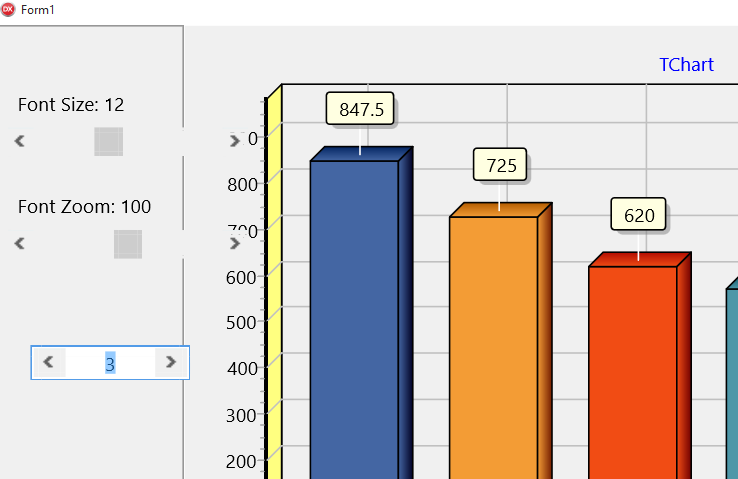

the issue is when its on a tlayout and that is then increased in scale
e.g via a spinbox
layout1.Scale.x:=layout1.Scale.x+spinbox1.Value/10;
layout1.Scale.y:=layout1.Scale.y+spinbox1.Value/10;
I could duplicate the problem with your test project

I have attached this test project to show the problem and pictures
tchartfonttest.zip
(57.47 KiB) Downloaded 1237 times
