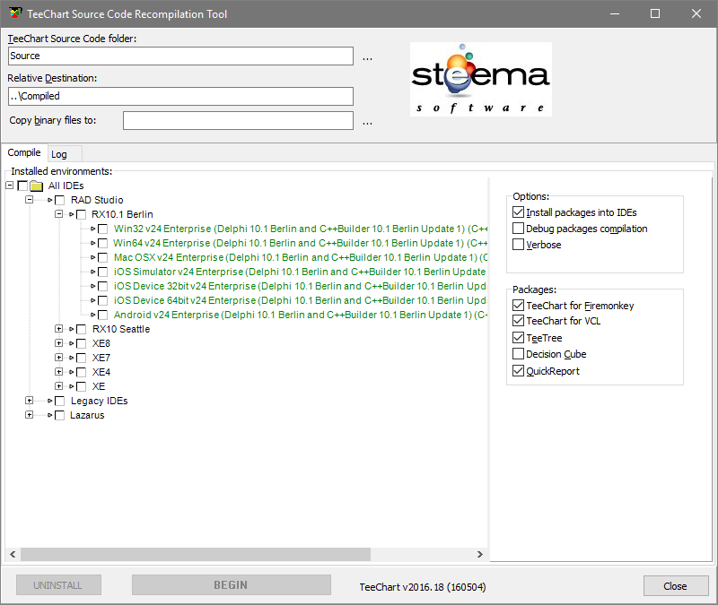

I've also recompiled TeeChart Pro v2016.18 SourceCode version for RAD 10.1 Berlin Update 1 using TeeRecompile tool included and found no errors:

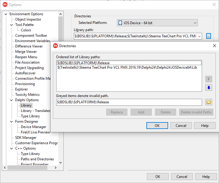

Please check the Library path in your "iOS Device - 64 bit" is correct and has no references to previous installations. By default:
C:\Program Files (x86)\Steema Software\Steema TeeChart Pro VCL FMX 2016.19\Delphi24\Delphi24.iOSDevice64\Lib
Note "TeeInstalls" is an Envioronment Variable defined in my IDE pointing to where I have the TeeChart VCL installations, because I have many.

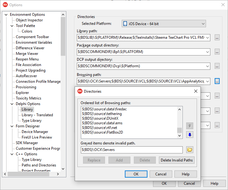

Remove any "tee" entry in "Browsing path" and "Debug DCU path":
