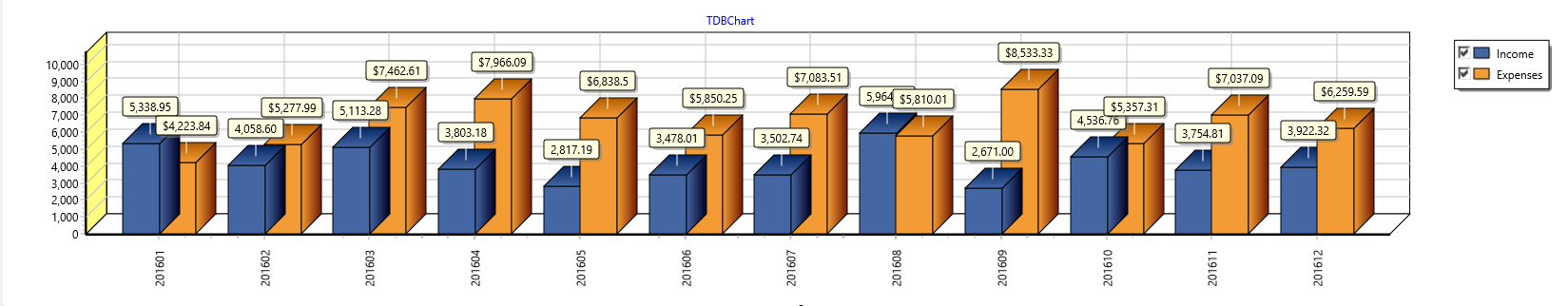

I have my chart bars set to 'Side'. But some of my bars Income bars look placed in front of my Expense bars. How can I correct this?

I could reproduce the problem so I've added it to the public tracker:
http://bugs.teechart.net/show_bug.cgi?id=1820
Thanks for reporting it.
